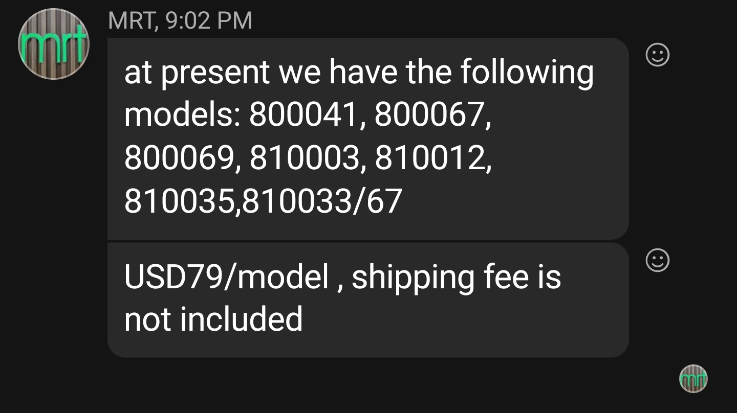

A response from MRT about models and very resonable price.

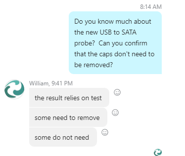

Up until now, I'm not so sure that they really care. They make no mention of the need to remove the 4 caps that we traditionally have to remove with the other similar style adapters already on the market. The implication is that this device is more advanced with a signal gain to compensate for it, but one would think that the caps should be mentioned. Here is the super clear response from tech support in regards to cap removal.
Call me fussy, but shouldn't the "testing" and "documentation" be done in advance by the manufacturer prior to final release? As usual, the customer pays to be the beta tester.
