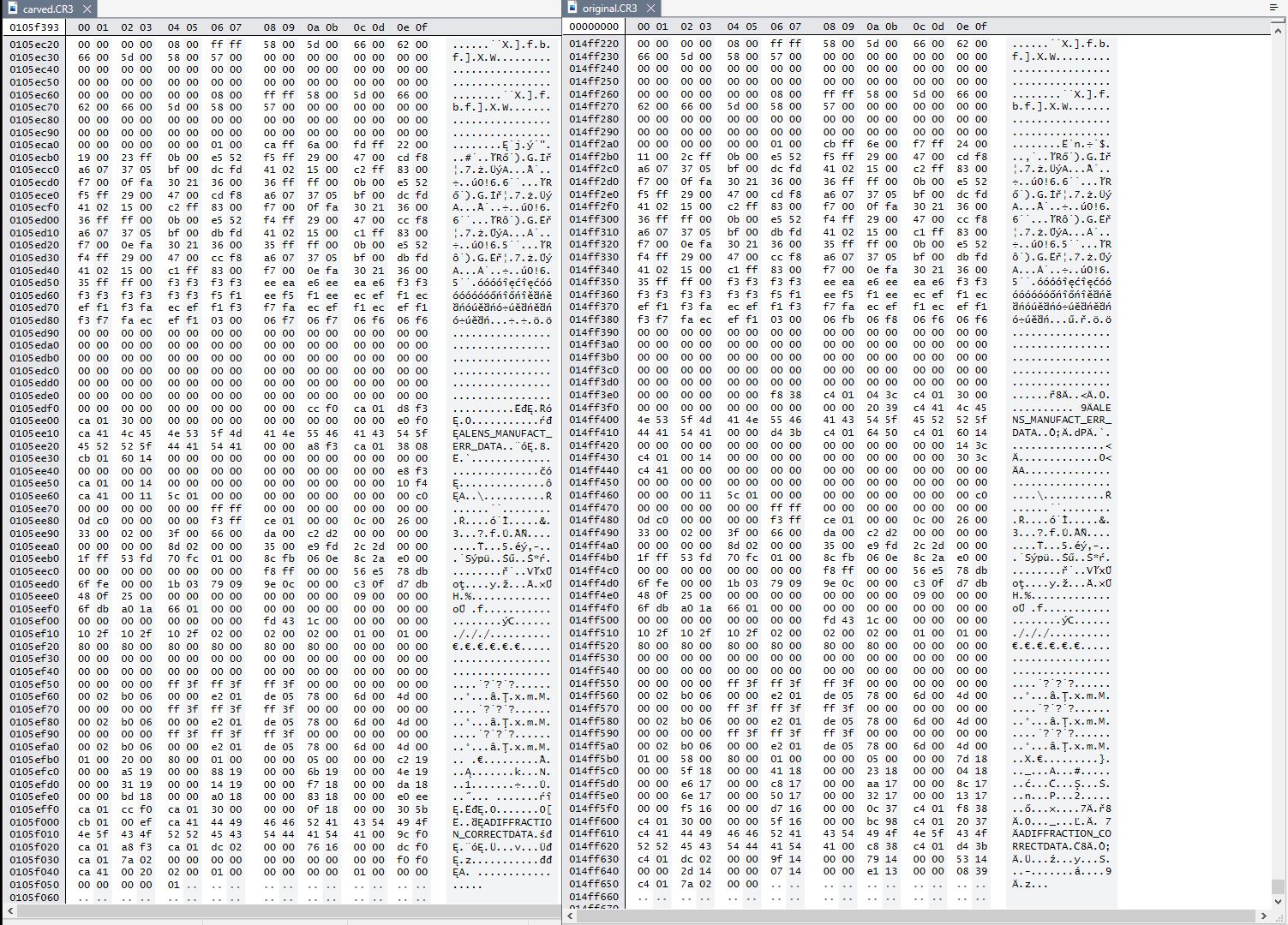

fzabkar wrote: Thu Feb 09, 2023 7:34 pm Could you post the first and last sectors of a good file and a carved file?
Hello fzabkar ,
beggining and end of carved vs originals attached, also few samples uploaded to gdrive.
https://drive.google.com/drive/folders/ ... share_link

This is a working file (A55A8928.CR3):
Code: Select all
Offset(h) 00       04       08       0C
0001DDF0  00000001 6D646174 00000000 007FDE66  ....mdat......Þf
The size of the mdat atom is 0x7FDE66. This corresponds to the range from offset 0x1DDF0 to 0x81BC55.
Code: Select all
0081BBF0  00006D18 000044DF BC012067 BC414449  ..m...Dß¼. g¼ADI
0081BC00  46465241 4354494F 4E5F434F 52524543  FFRACTION_CORREC
0081BC10  54444154 4100B468 BC01C06B BC01DC02  TDATA.´h¼.Àk¼.Ü.
0081BC20  0000FF16 0000E016 0000C116 0000F468  ..ÿ...à...Á...ôh
0081BC30  BC017A02 00000000 00000000 00001069  ¼.z............i
0081BC40  BC410020 02000100 00000000 01000000  ¼A. ............
0081BC50  00000000 0100                        ......
This is a partially-working carved file (f938081352.CR3):
Code: Select all
000A35F0  00000001 6D646174 00000000 01D8F866  ....mdat.....Øøf
The size of the mdat atom is 0x1D8F866. This should correspond to the range from offset 0xA35F0 to 0x1E32E55. Instead the file ends at 0x1E32E54.
Code: Select all
01E32DF0  BE01C0E2 BD414449 46465241 4354494F  ¾.Àâ½ADIFFRACTIO
01E32E00  4E5F434F 52524543 54444154 41004CE4  N_CORRECTDATA.Lä
01E32E10  BD0158E7 BD01DC02 0000F816 0000D916  ½.Xç½.Ü...ø...Ù.
01E32E20  0000BA16 00009B16 00007D16 00008CE4  ..º...›...}...Œä
01E32E30  BD017A02 00000000 00000000 0000B0E4  ½.z...........°ä
01E32E40  BD410020 02000100 00000000 01000000  ½A. ............
01E32E50  00000000 01                          .....
Therefore ISTM that the .ini file should be tweaked to correctly calculate the size of the mdat atom, assuming that is even possible. Otherwise you could carve an additional sector, and then write a tool to truncate the carved .CR3 file to its correct size (is that in fact what you are doing?).
