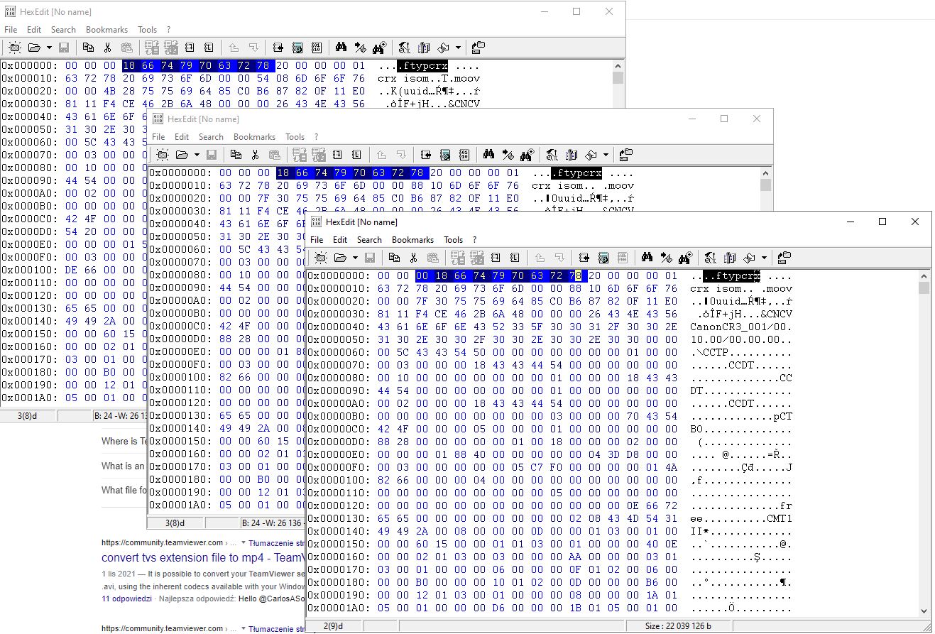

FS (mft) in this case is damaged beyond repair due to PBA reading, no CR3 samples :/ Cient sent me 3x photo from the same R6. Just compared file headers with yours - the same :/
No idea what`s going on, maybe some setting in camera itself involves file header change (but i doubt it), it`s still under investigation, i`ll share solution if found :)

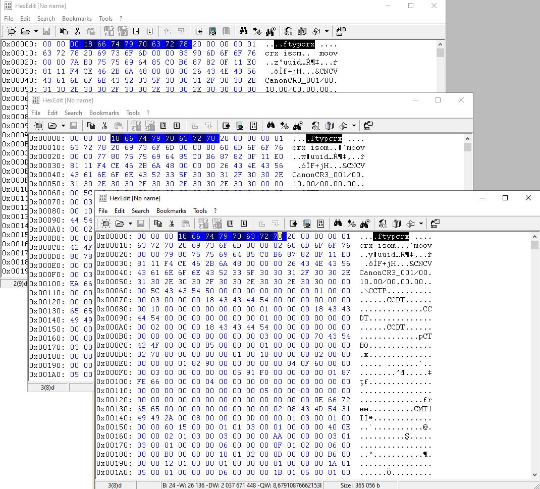

... one more thing, all carved Canon R6 CR3's are 357KB, headers are correct. Samples attached.
Regards,
Davey

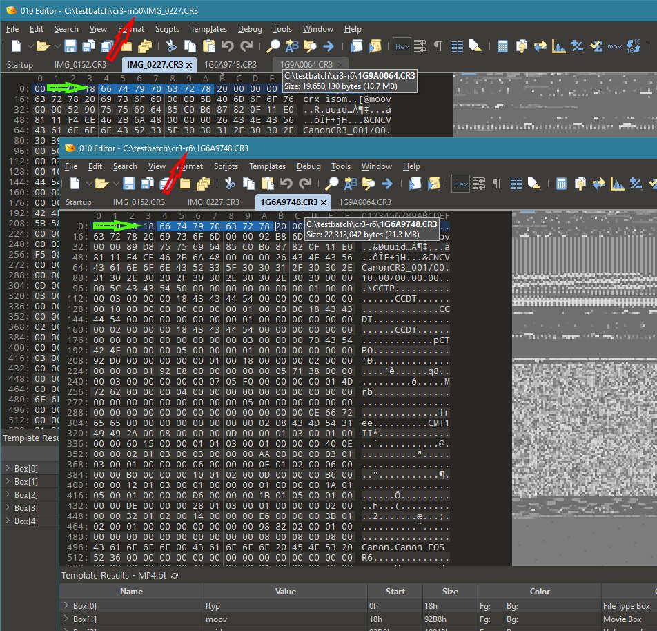

Re: Canon R6 CR3 format
Seems to me carver makes an error.
m50 file structure is ftyp - moov - mdat
r60 file structure is ftyp - moov - free - mdat
It is as if the carver decides to end carving when it encounters the 'free' atom. I bet if it just continued and ignored the free atom the CR3 could be correct.
Can you share the intact ones, 3 or so, from his camera, I only have a few I got from internet? Perhaps we can come up with a EOF rule.
