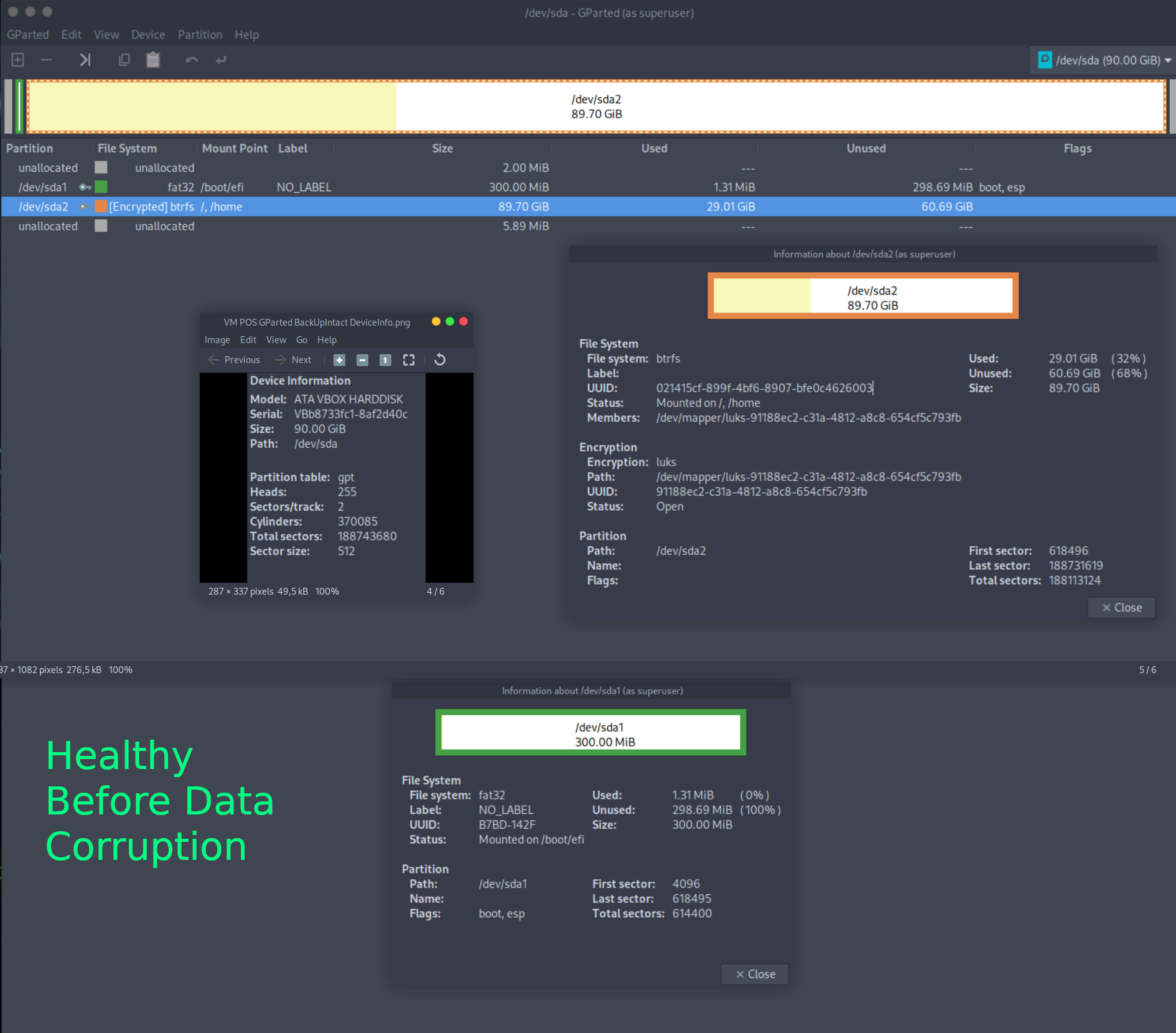

The screenshots from GParted show the disk before the Data Corruption occurred:
GParted Healthy Partition
VM POS GParted OS Intact.png (440.14 KiB) Viewed 23583 times
