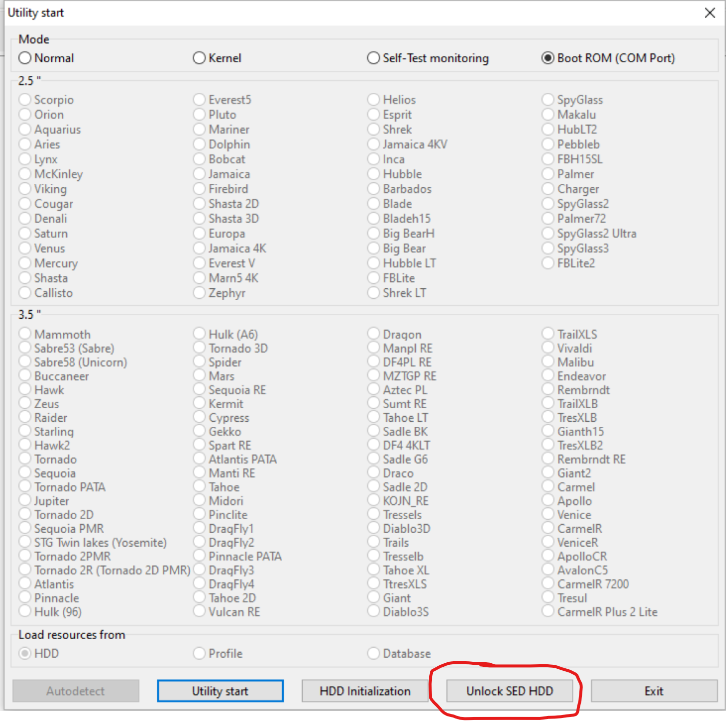

My PC-3000 does not support unlocking WD50NDZW-11A8JS1 so I need to update to version 7.1.10.
It is possible to help me unlock the WD50NDZW-11A8JS1 ROM file so that I can read SA from the hard drive.
Thanks in advance

Open the Western Digital Marvel utility on PC3000, click on Unlock SED HDD, select the saved ROM file, click Unlock HDD (with SA access) and then write that file back to the ROM with a programmer.
