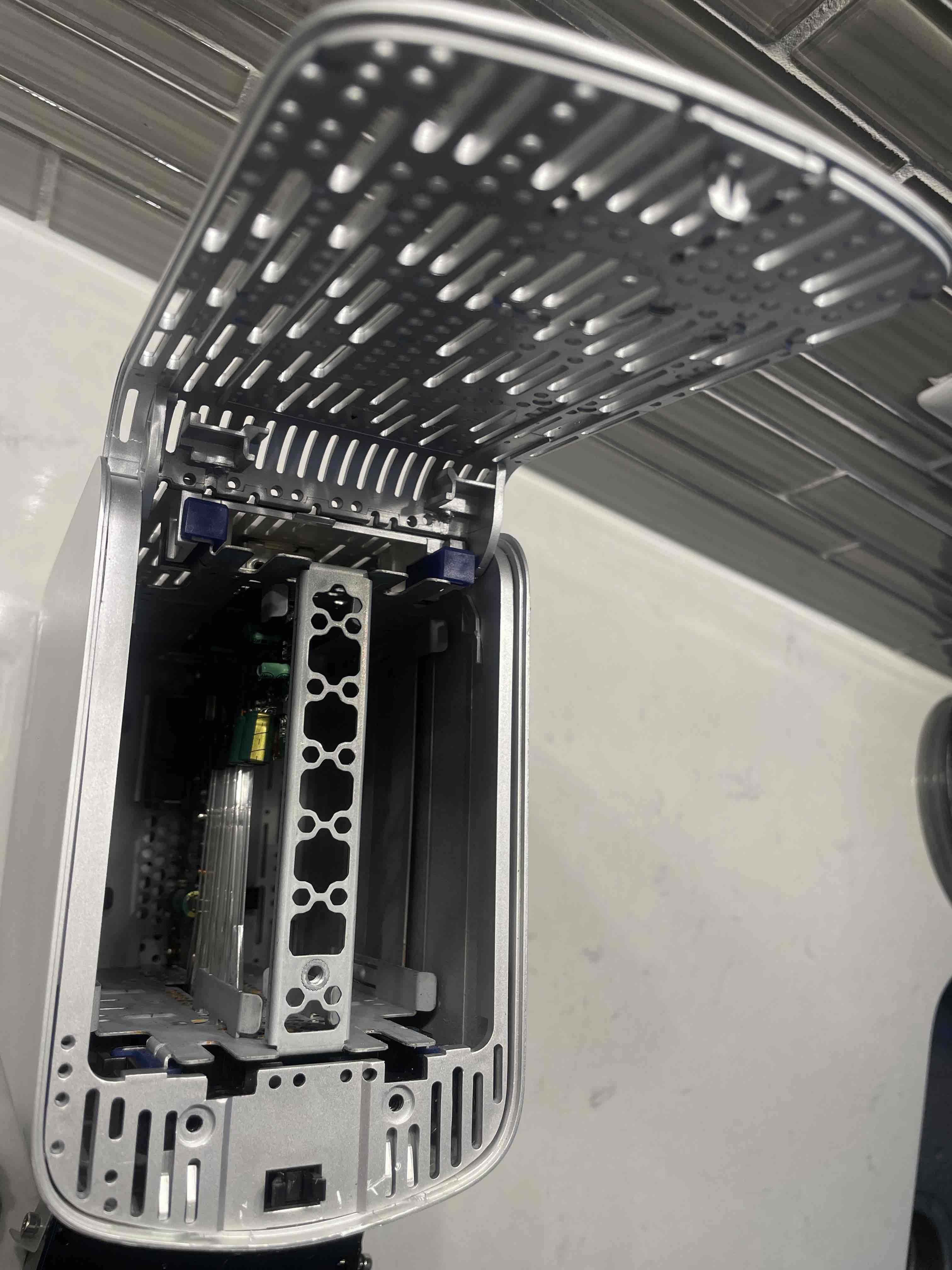

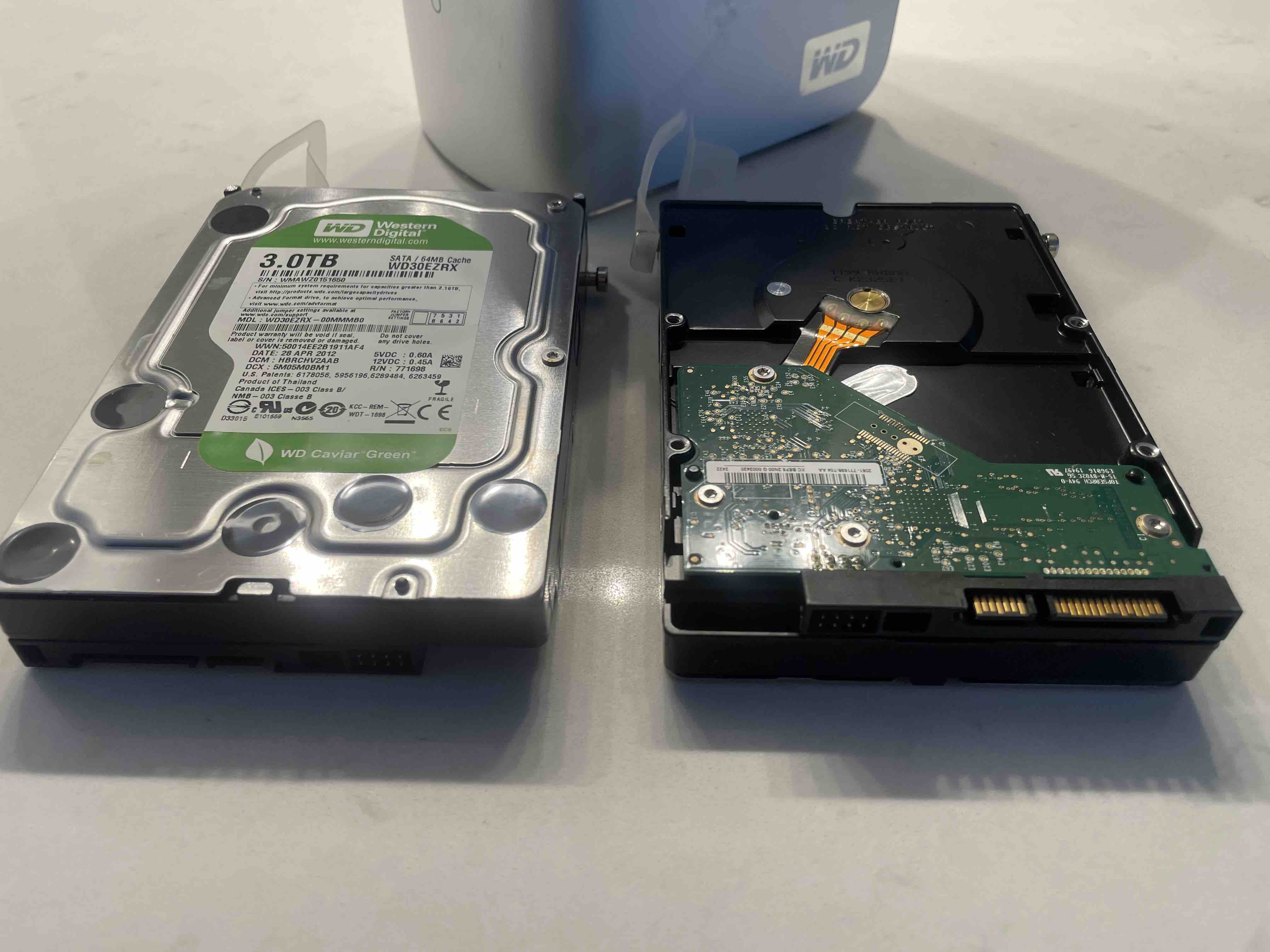

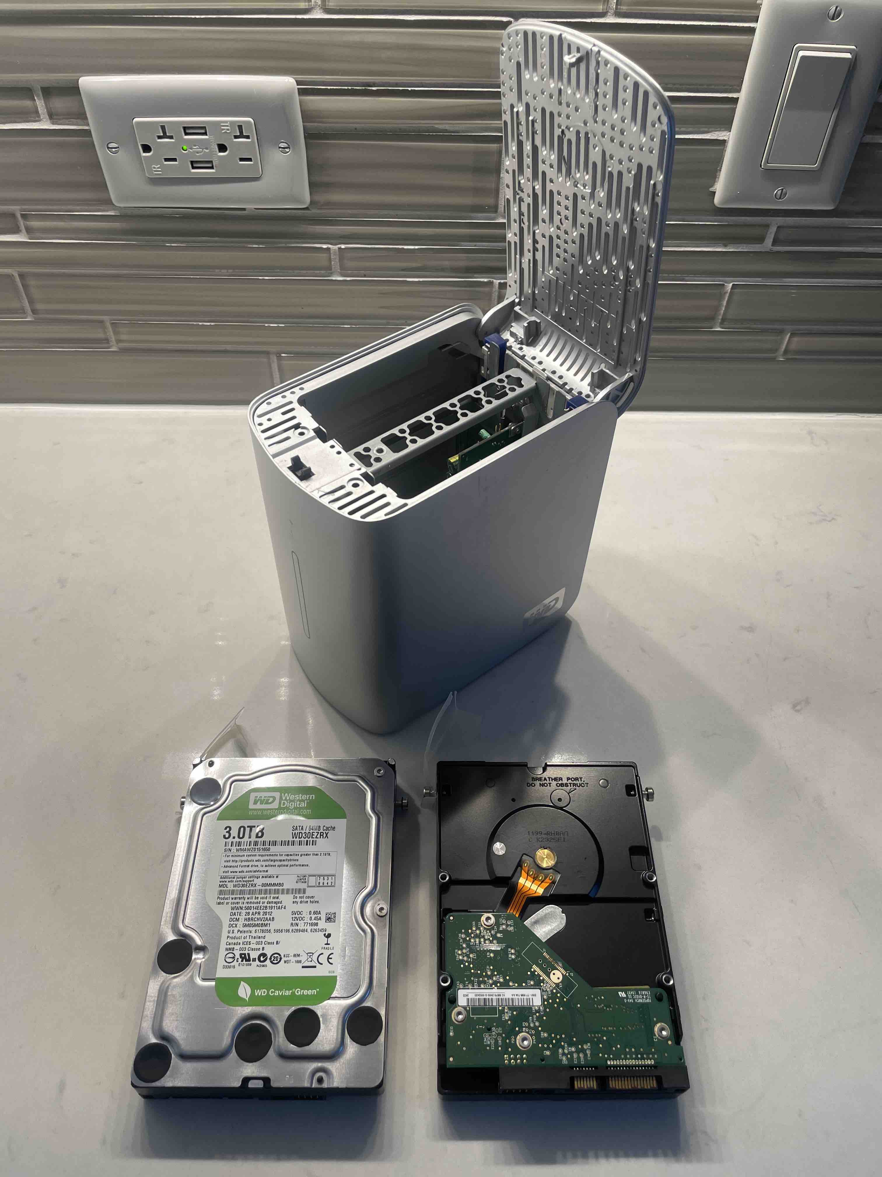

Hello, this is my 1st post and the reason why I joined. I have a water-damaged hard drive 6TB that had water on-or-in it for 1 day and then I dried it out. I see no water corrosion damage anywhere on the drive itself or the internal control board in the chassis or housing.
This hard drive would not power up when plugged into a 15" MacBook Pro but it did when plug into a 27" iMac using the same stock AC adapter. The power status with the 27" iMac has the front light blinking but no spinning of the platters.
I read that it could be a problem with the control board in the housing unit and to use a SATA-USB connector straight into the computer which I've done to no avail. I've tried this 3.3V pin tape-hack explained in Step 14 here -
https://www.ifixit.com/Guide/How+to+Shu ... ive/137646
...and still nothing on both drives. I don't know what else I can do which is why I'm asking you. Some extra links to the exact model I have with the online manual and attached photos. Any advice is greatly appreciated, thank you.

@SennaSempre, if you don't have access to a computer with a SATA port, then get a USB-SATA adapter that supports your 3.5" drives.
Something like this ...
https://m.media-amazon.com/images/I/61Q ... _QL80_.jpg
Power up each drive and show us the Partitions tab in DMDE. DMDE can reassemble your RAID and recover your data.
I have already asked you to do this at Tom's Hardware, yet you insist on pursuing some pointless and potentially dangerous ideas. Moreover, before you start suspecting "voltage diodes", at least get hold of a multimeter and measure them. You can't test these diodes by pointing-and-clicking a mouse.

Re: Water-Damaged WD MyBook Studio Edition II Quad Interface 6TB
If the drives are really good, you can recreate the RAID using software for that purpose.
But then again: why don't you contact a local lab and get that sorted once and for all?
You have no understanding of the hardware. Messing about with RAID docking stations is dangerous because there is always the question of how the bridge firmware will deal with foreign drives.SennaSempre wrote: ↑Thu Feb 01, 2024 8:35 amYour USB IDE/SATA Cable is no different than the purpose of a RAID Docking Station which I'm looking into. But how would my RAID 0 drives be readable if there is no WD code-matching RAID Controller in either this USB IDE/SATA or the RAID Docking Station? Don't I absolutely need to have that Controller to link the RAID 0 and see my data?
Just buy two USB-SATA adaptors and allow DMDE to assemble a virtual RAID. DMDE then acts as a software RAID controller. Once you get to this point, use DMDE to recover the files from the virtual RAID to another drive.
Assuming that the OP doesn't want to risk losing the data, the safest steps (short of sending to a pro) are as follows:
1. clone both drives (~ 12 hours + cost of 2 drives to clone to)
2. use data recovery software to virtually rejoin the strip, recover the data from the clones in ro mode and saving the data out to a new destination drive (up to a few days + the cost of the software license and the destination drive)
Any attempt to plug the original drives into anything that may write to the drives is a huge risk, especially if it is a RAID device that might immediately start to modfiy all the sectors without warning.
