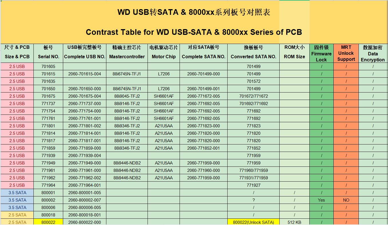

Western Digital USB to SATA board compatability chart
Source - MRT Lab

To me, the table is a little sloppy.
It's not "serial no.", it's "part number".
The USB and SATA versions for 2060-800022 show the same numbers.
"A21U5AA" is not the motor chip -- it should be "WD Nautilus".
https://recuperodatos.com/sites/default ... 1-PCB.jpeg
https://recuperodatos.com/sites/default ... 60-PCB.jpg

To be honest, I didn't even look at the tables before posting, assuming that would have gotten it right. Oh well.
