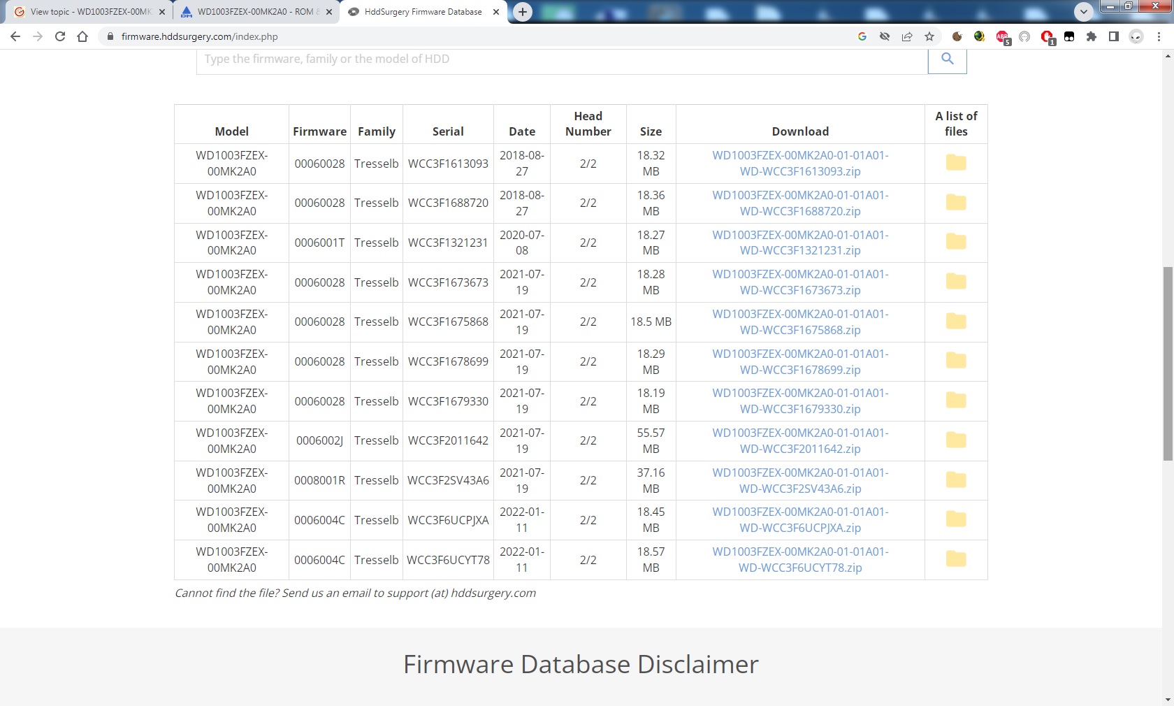

i need ROM and LDR for WD1003FZEX-00MK2A0 drive with following micro codes:
60042
60038
6003J
Thanks.

Hi :)
Family is TresseLB.
Yes, by micro code i mean rom / ldr version.
I already tied all this without success.
rom provate.jpg (324.74 KiB) Viewed 47242 times
Original rom was destroyed by customer because pressed rom chip with a lot of force between twezeers and very high temperature.

Yes, case solved.
The drive was always busy so i couldn't generate rom adaptives.
I had to use TV9-TV10 shorting, then i fixed DIR module.
There were issues on SA, for this reason i couldn't generate rom adaptives first.
Thank you.
