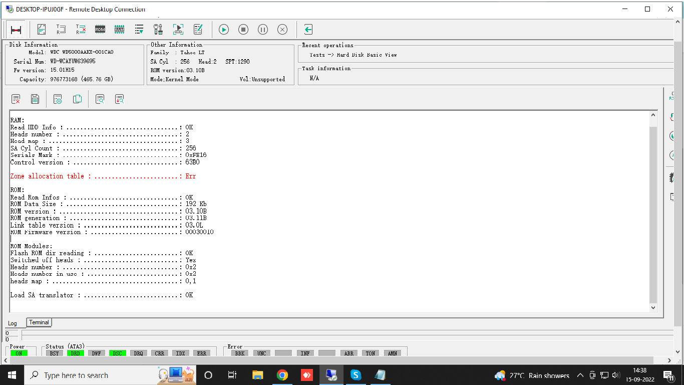

hello please help me
I have zero fill in 03 module, I have not access User area and module.

Zone allocation error is nothing to worry about.
What do you mean, "zero fill in 03 module?" Does that mean it was already filed with 0x00 or does that mean you filled it with 0x00?

I filled it with 0x00
Re: zone allocation table error
You might want to write the backup back. Please run a SA structure test and post the results here.

I have tried Drive goes spin off And and speed is too slow 03 is write failed
Are you saying that it spins down after a few seconds? If so, you need to deal with the physical issues (PCB, heads or surface damage) before you spend any more time trying to mess with the firmware.
