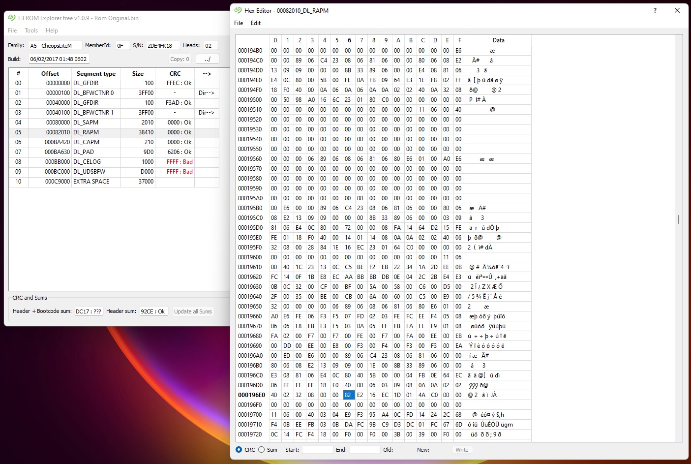

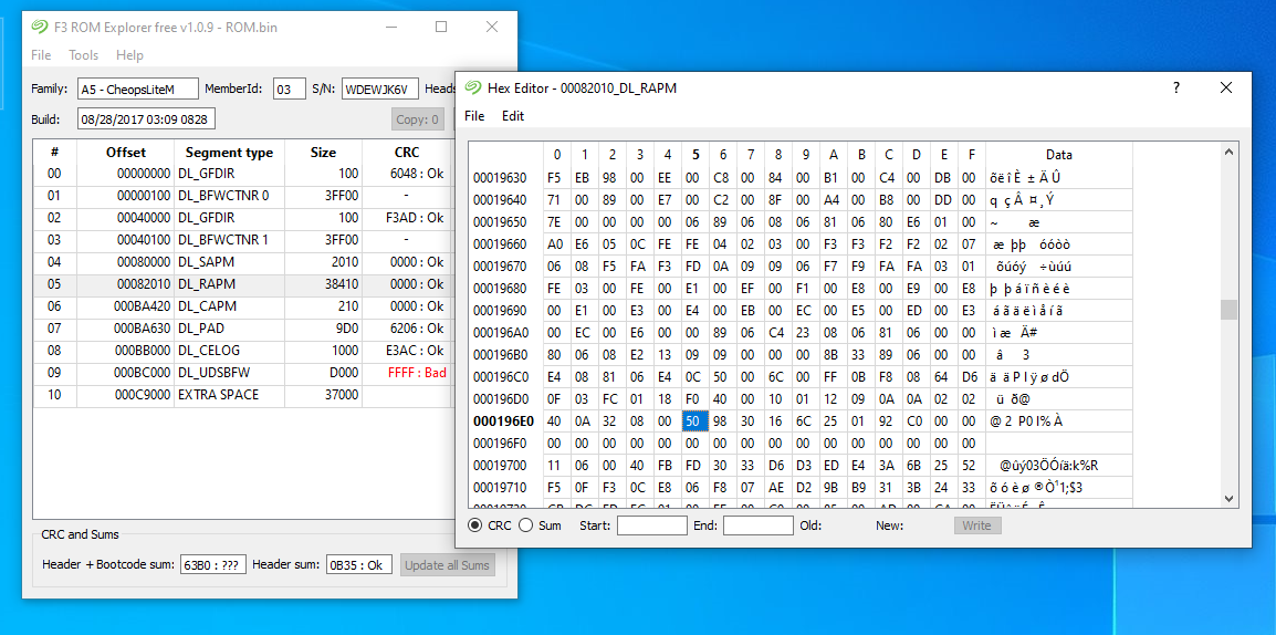

Re: ST500LM030 Rosewood A5 made noise how to enter Terminal to see PreampType
The location is not consistant. Here is a screen grab of the RAP in your ROM showing where I found it.
hvd
Posts: 14
Joined: Sat Aug 12, 2017 5:59 pm
Post by hvd »
Hello
Yes, it is not specified. How do 82 02 become 82 E2?
ACE does not give me the answer, in my opinion we have to wait for ACE to find the solution for us.
82 is the only part that matters...the other is insignificant.

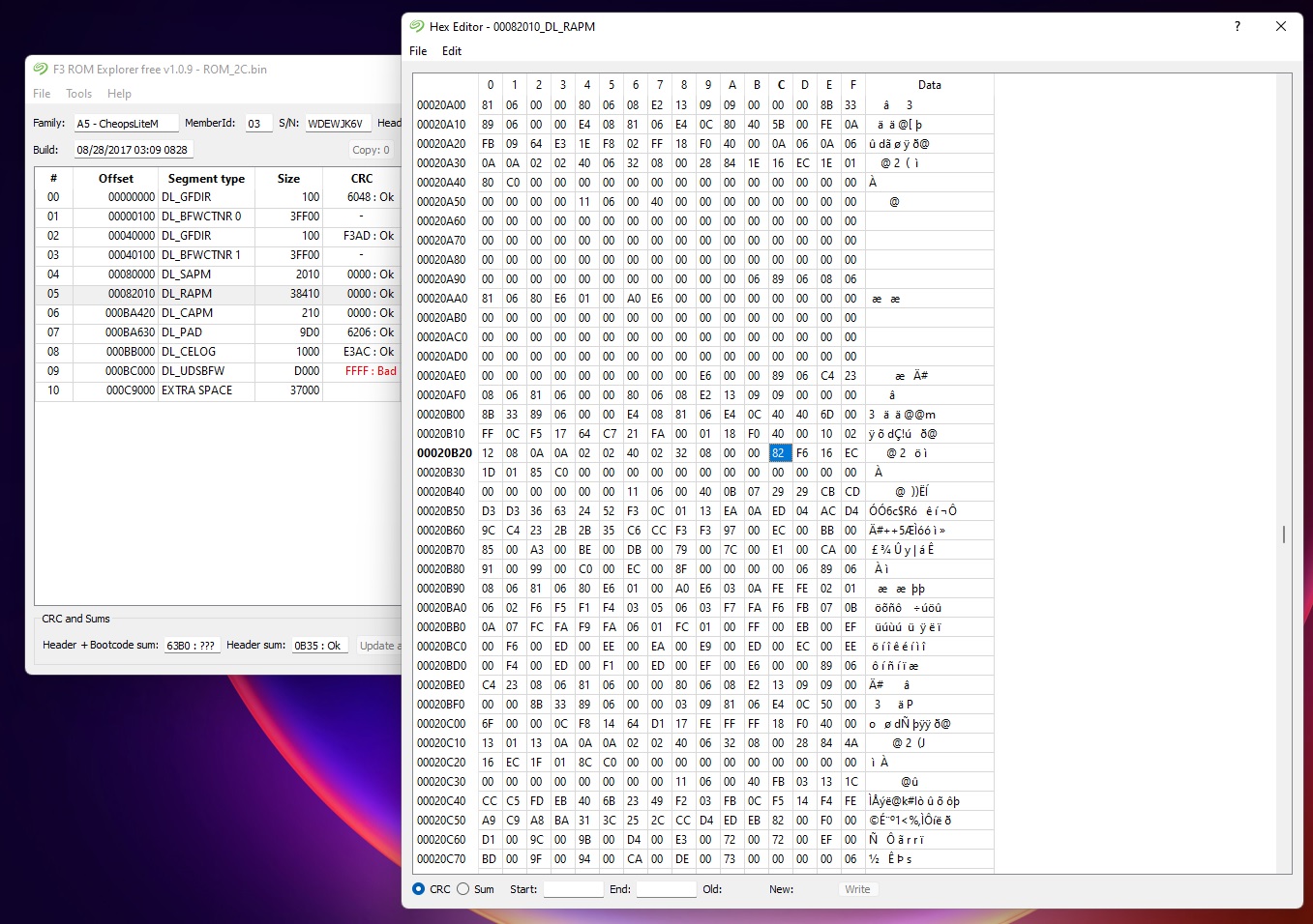

I tried to take an ST1000LM035 hard drive with PreampType C2 02
I look for position 000196E0 which it does not find C2
I send you the ROM and the photo
Thank you for your help
ROM_2C.zip
(463.91 KiB) Downloaded 1452 times
As I said, the location is not consistant.
