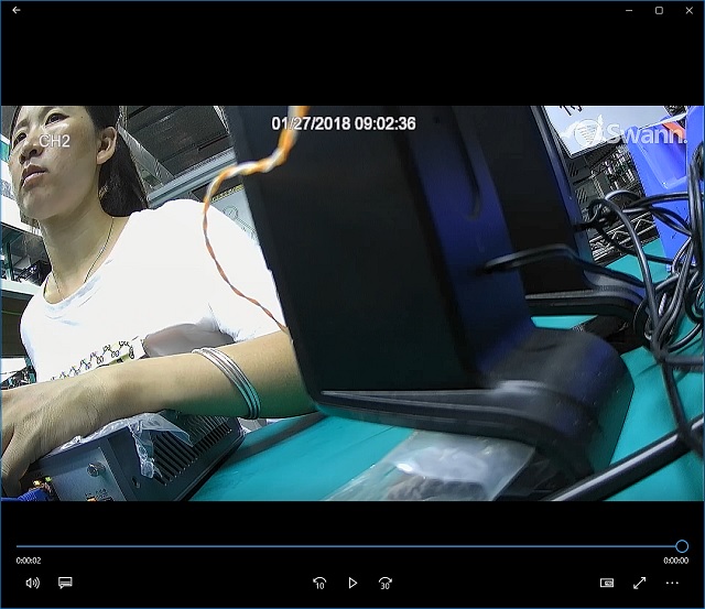

myCCTV - I ran the scan for a couple minutes, long enough for the app to find the file structure, quit the scan and had access to all the video almost imediately. The built-in player was very handy to test and verify that we had everything and that the videos worked before saving the video content out.

Hey, myCCTV is so good, it even recovered recordings of the system being tested at the factory in China. (technically, hxdvr found this too in the partial scan)

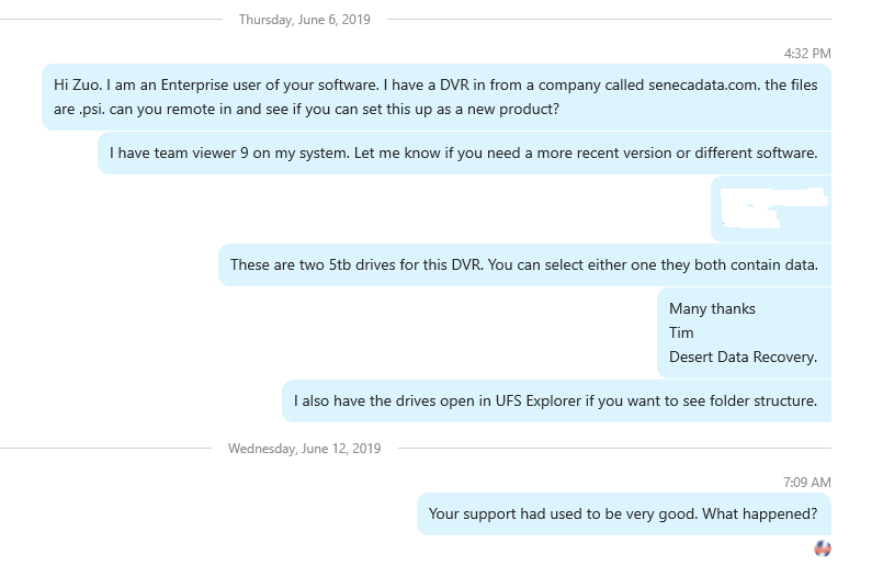

I have tried to contact HXDVR several times recently for support for DVR types that were not in the database. However I never get a response from him anymore. This is a Skype enquiry from June 6th and June 12th that he never replied to. And considering I am an Enterprise user it is pretty bad support not to even respond.

That is odd. My only issue with seeking support with HXDVR is because of the 12 hour time difference, which means that support runs over a few days, rather than right away.
