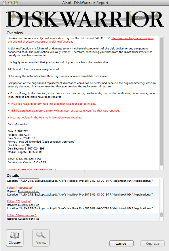

I'm a bit of a noob when it comes to data recovery. This hard drive is quite new, but randomly stopped working. It mounts fine on my Macbook pro, and I can see most if not all files, but when I go to open one, or copy one, it freezes and I have to unplug it and plug it back in. I tried ejecting it and unmounting it through disk utility, but it's just too frozen. It also crashes finder. I've tried using diskwarrior as it's worked before to rebuild the directory but it can't because of a disk malfunction. I'll attach a screenshot of the results. It mentions a "Preview" that I should back things up from, but I'm not entirely sure what that means. Any help would be greatly appreciated! I'm willing to take it apart if need be, I'm decently savvy when it comes to electronics.

Is the data valuable to you? That is, if the drive quits completely, are you okay with losing it all?
These drives frequently have head, media and firmware damage which could cause your symptoms.

If it is valuable, you are probably best to have it looked at by a professional before it gets worse.
If you are to try anything at all, try to clone with ddrescue, then try to recover from the clone.
