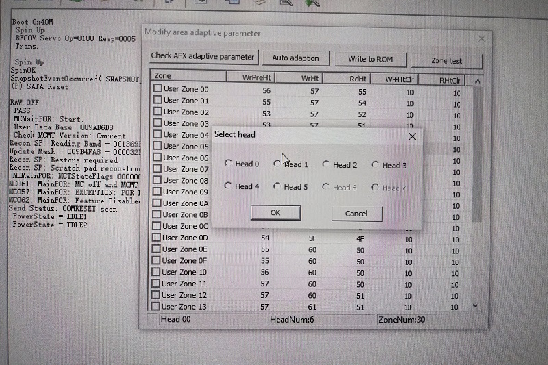

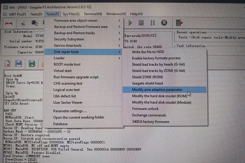

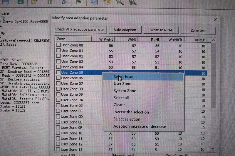

Here is a few screenshots to show how to get there. I may, when I get another chance, add a few more shots showing the process to change the values for those who need to see every step.
Edit AFH.jpg (238.7 KiB) Viewed 38622 times
