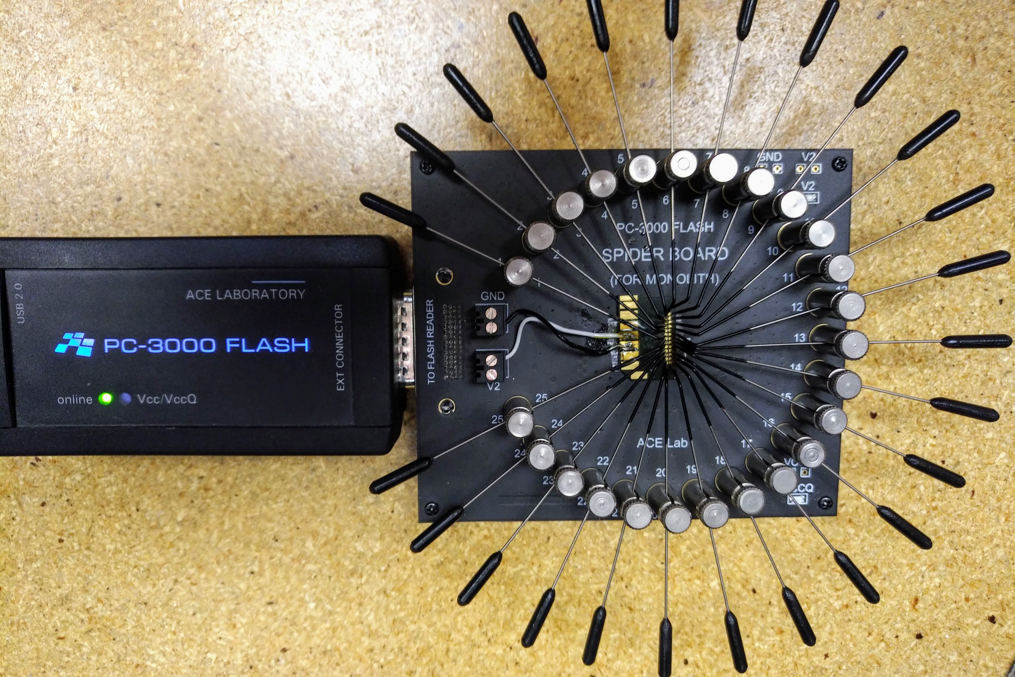

We were able to read this card using our Spider Board with our PC3000-Flash recovery system. Sadly, getting the dump of the internal NAND is the easy part.

Honestly I think that the spiderboard has little efficiency I use it but using the needles is complicated and you have to be very careful because they easily move and can damage the monolithic, what do you think?
Re: 128GB SanDisk Monolithic SD Card
Yeah, I find the spiderboard needles too large, causing some serious gymnastics to be needed in tight spaces...and it does scare me that a simple slip can cause some pretty nasty damage.

Also the spider board doesn't tell you if you don't have a connection. ie it will tell you if there is a short on a connection, but if you have missed a pin, it will still say the connection is good and show it as green.
