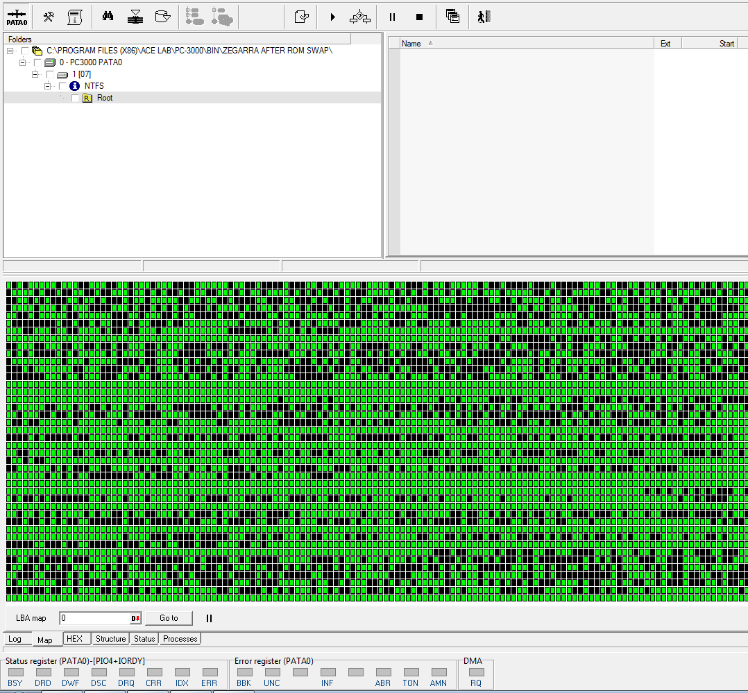

I guess i could have done that. I've never done it that way. You mean just visually look at the order and write that configuration to the ROM?
I ended up swapping the ROM and was able to get FULL & correct ID.
I was also able to get about a million sequential sectors imaged and it was reading extremely fast, over 90MB/s if I recall correctly.
Now its acting up again as ion the beginning by not reading and not giving ID anymore.
DE reads random sectors but its a mess with lots of errors. Pic attached.
