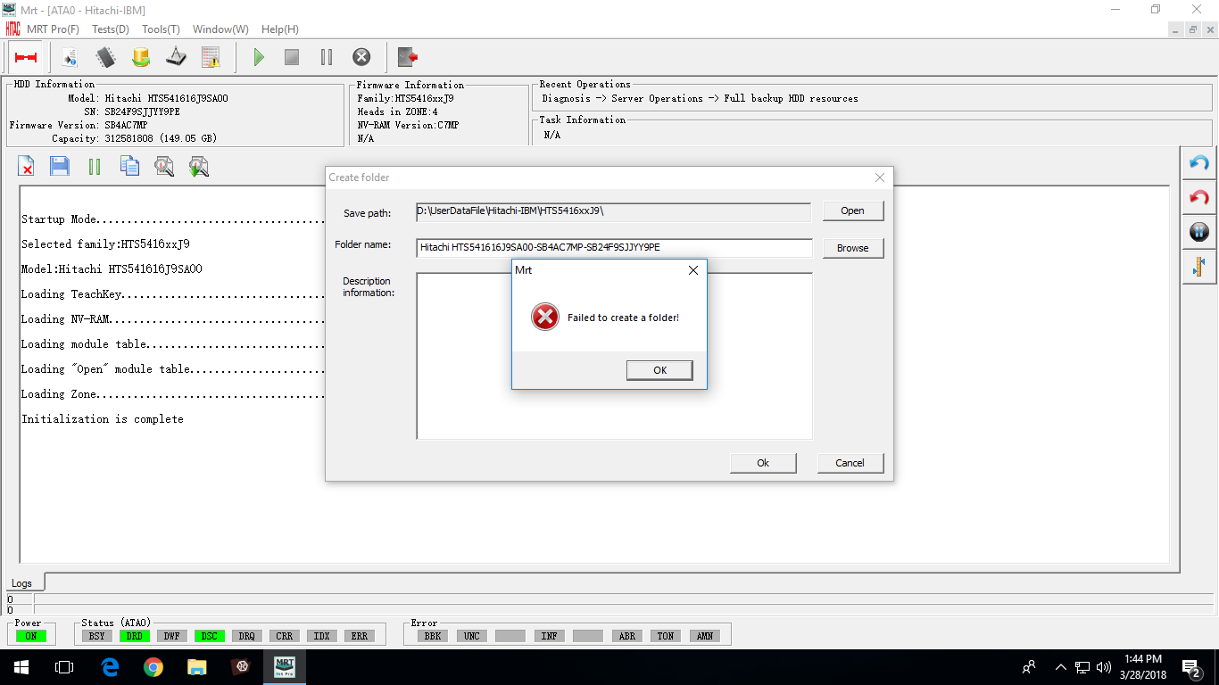

  • Can't save resources if the save path is changed from C:\UserDatafile to D:\UserDataFile (screenshot in post below)

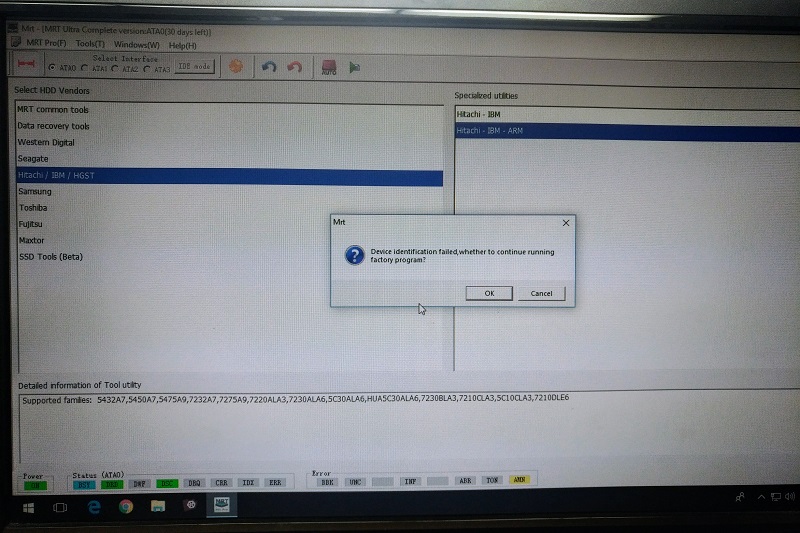

Hitachi HTS721010A9E630 not detected
Update: This issue seems to have gone away. I thought, for sure, I rebooted the system yesterday when trying to troubleshoot it. But, it is gone now that I power it on this morning.

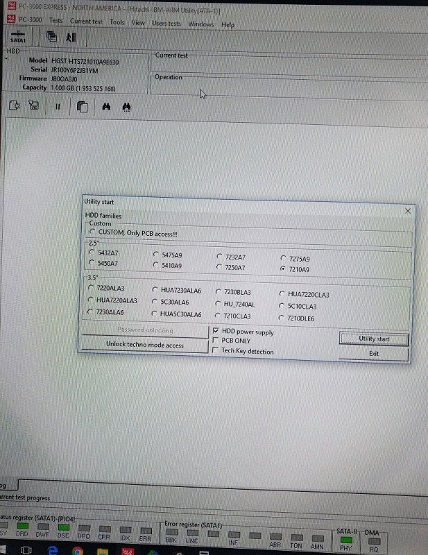

I have a Hitachi HTS721010A9E630 that does not ID on MRT. I tried port 0 and 2, neither worked. I tried to force the drive to detect with tech key using the closest utility match possible, as 7210A9 is not supported. The good news is, the drive detects flawlessly on PC3000.

Just received a second 7210A9 drive that did not ID at all on MRT, yet IDs perfectly fine on PC3000.
Note: As just mentioned above, this issue seems to have gone away. I'll keep a close eye on it.

I moved the default Save path from "C:\UserDataFile" to "D:\UserDataFile" and now get a "Failed to create a folder!" error when trying to save resources. It works fine when I move it back to the C drive. DE is still able to create a task and image drives with the save path set to the D drive.

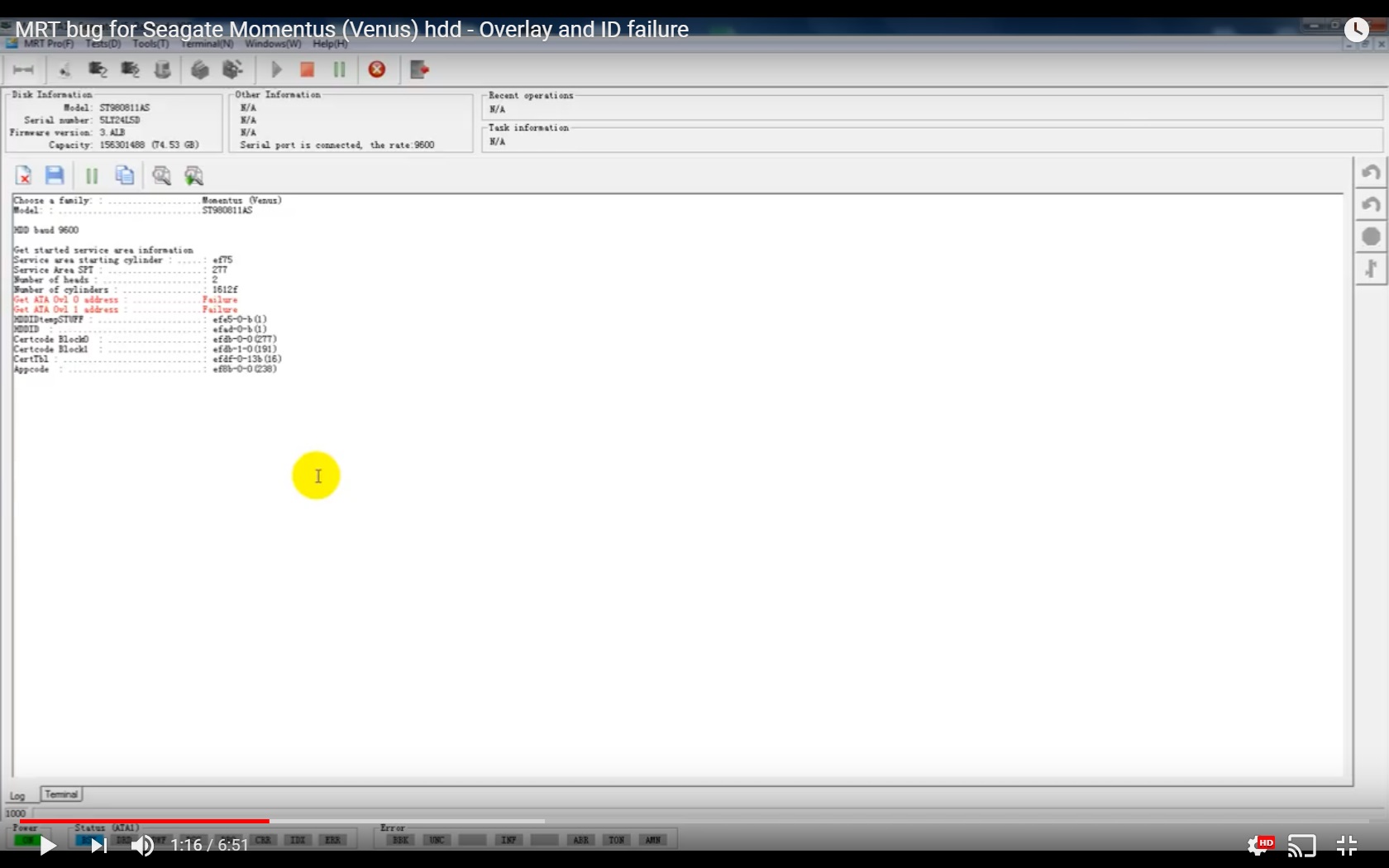

i've found a bug relative to Seagate Momentus 5400.3 (Venus family).
Utility is not able to read ATA overlays and reads ID incorrectly.

This drive is perfect, i can read all user data on surface. I also tried to read firmware modules of another good Venus drive that i have, it also behavies with exact same issue when reading ATA and ID.

Sediv is able to read fw resource from Venus correctly, i can prove it with this video:
https://www.youtube.com/watch?v=dz7NE0kFTmI&t=907s

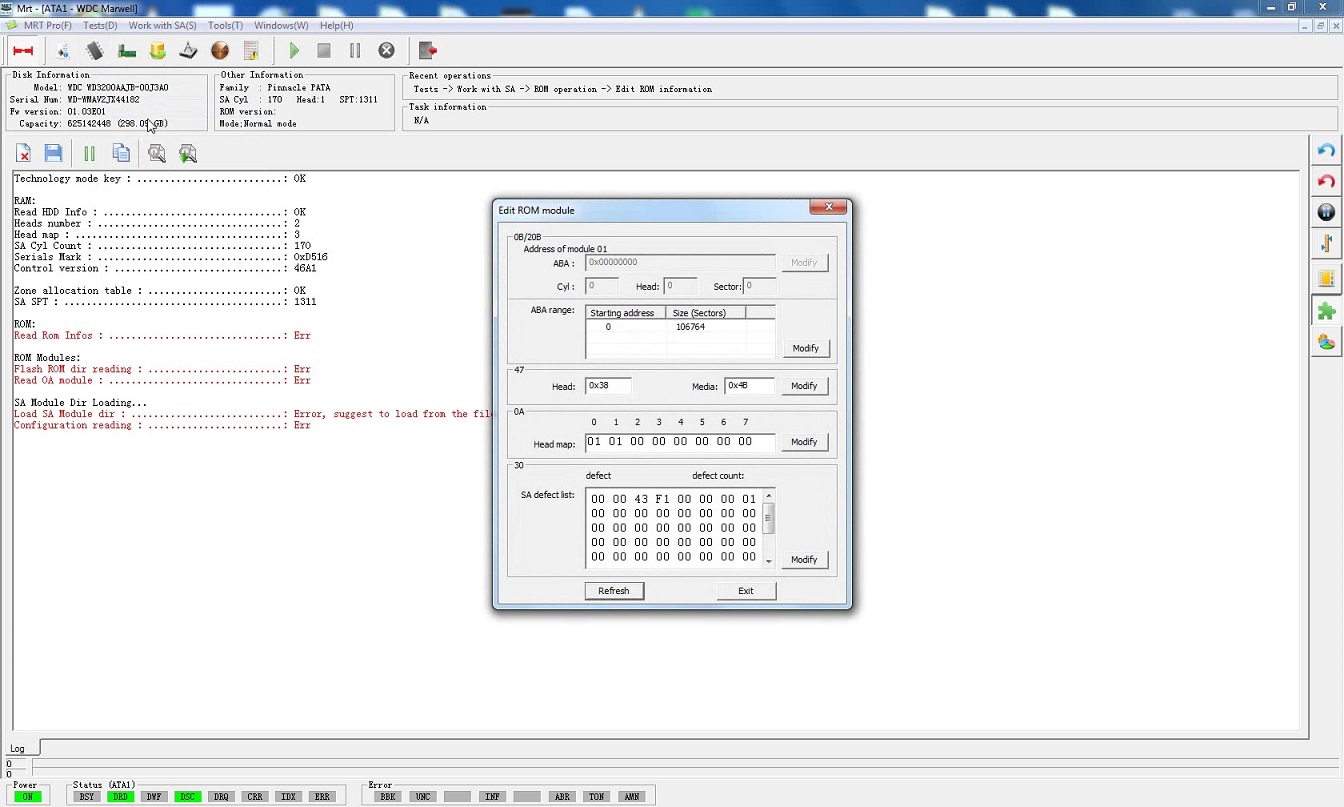

I've found another MRT bug in WD utility, this time related to Pinnacle Pata family.
Utility is not able to read ROM and SA.
https://www.youtube.com/watch?v=1TzDJFuhvXs
