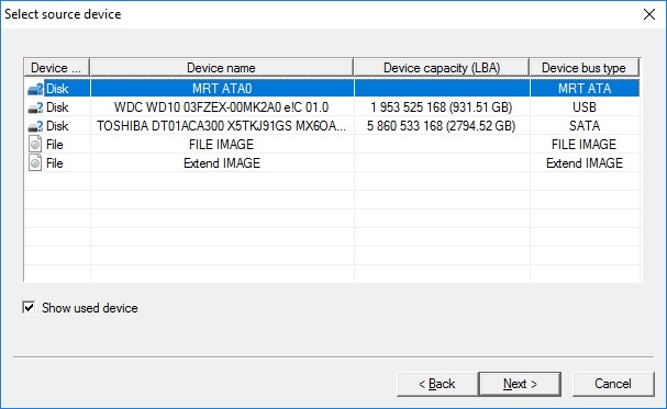

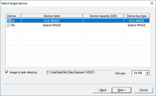

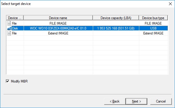

As you can see by the attached images, the destination drive was not showing. But, somehow, it suddenly showed the next time I created the task. Weird.
Select Source Device.jpg (60.16 KiB) Viewed 32903 times
Select target device.jpg (52.27 KiB) Viewed 32903 times
Select target device (now showing).jpg (50.47 KiB) Viewed 32903 times
Re: Image to drive not showing in DE
Doh! Just tried another project and it, again, is no longer showing the destination drive on the list of destination drives, although it shows up on the source list.
