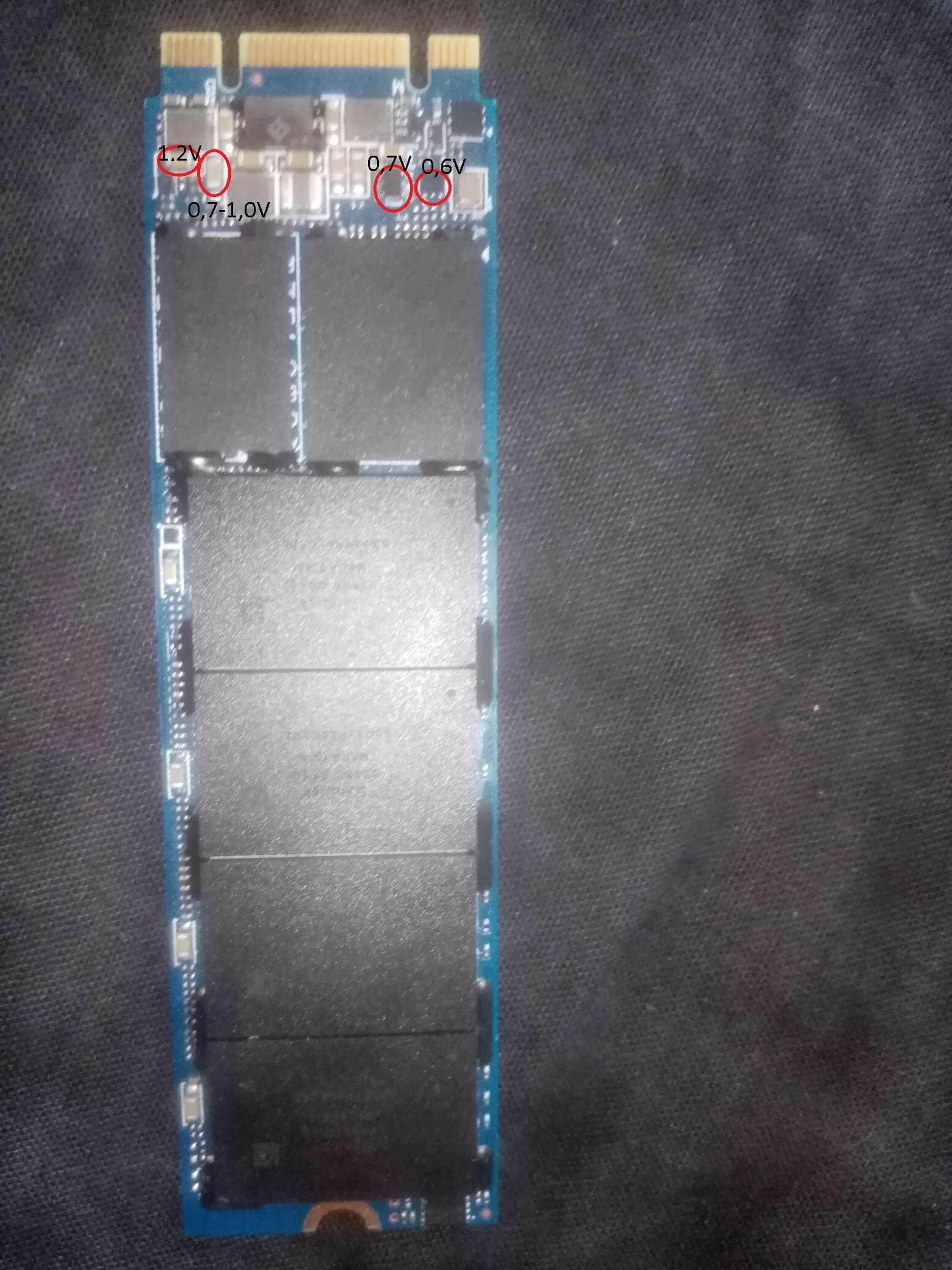

Yea 88ss1074 bsw! I checked the board with multimeter. Mostly every component was between 3,1-3.3 V. Some components tho had 0,7-1.3V. I cant really find good info about these components, or what values should them have? Maybe voltage error makes the drive inaccesible by dead components. Ive posted picture. Im total noob in electronics, maybe someone with expertise could tell me.

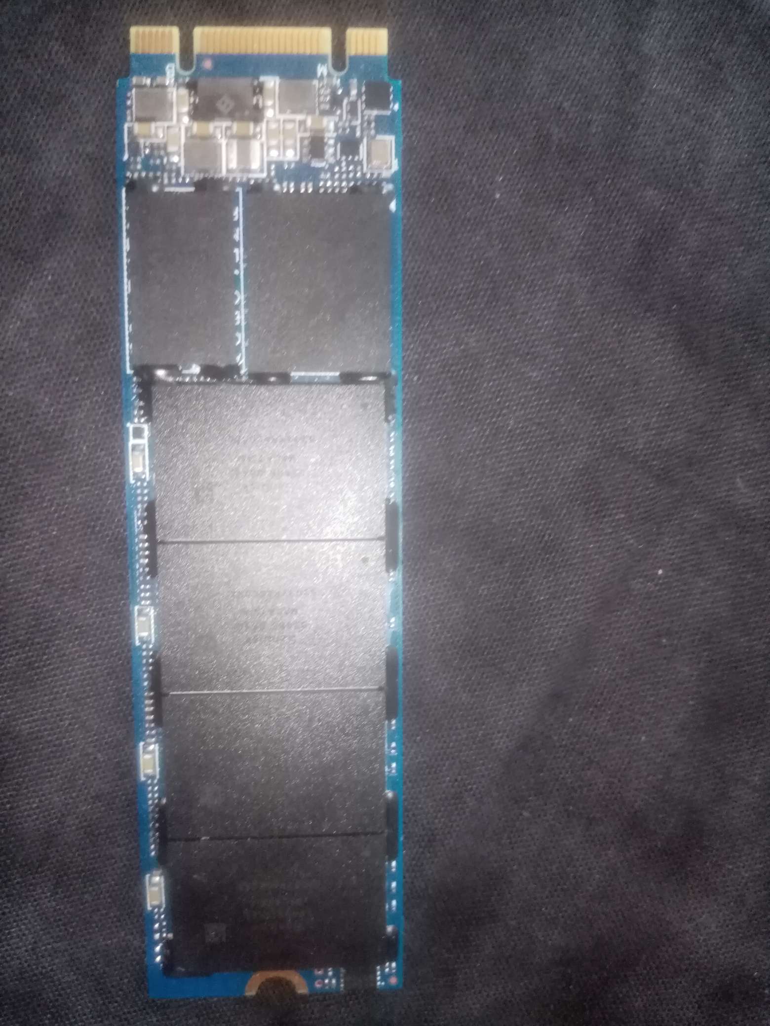

Can you show me a detailed photo of the chips near the m.2 connector? There are 4 inductors which will be the landmarks for 4 power supplies. There is also a 6-pin MOSFET which switches power to the whole drive.
