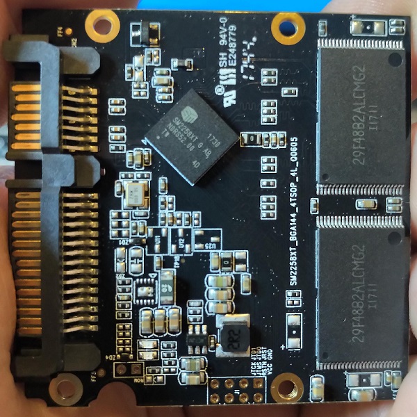

Model: 120GB SSD (yes, for real. Doesn't even have a label on the casing)
Controller: SM2258XT G AB
Symptoms: Detects correctly, but absolutely no LBA access
Solution: Not yet supported with PC3000 SSD. Recovering using custom methods.

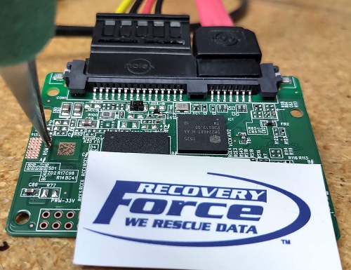

Model: 240GB SanDisk SSD Plus
Controller: SM2246XT H AA
Symptoms: Stuck at BSY and does not ID
Solution: Virtual translator. Reads about 2/3 of the sectors good.
Amendment, after reading at about 200KB/second for several days, we are only reading about 1/4 of the sectors, with 3/4 being unreadable.

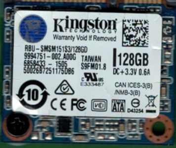

Model: 128GB Kingston SMSM151S3/128GD
Controller: PS3109
Symptoms: No access to data
Solution: Virtual translator. Reads 1-3MB/sec with some bad blocks

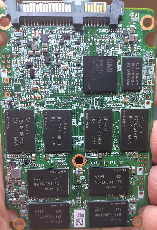

Model: Intel 256GB SSD Pro 5400s Series
Controller: SMI N00K24
Symptoms: Comes ready, then goes BSY when trying to ID
Solution: No firmware support with PC3000, but readable with DE

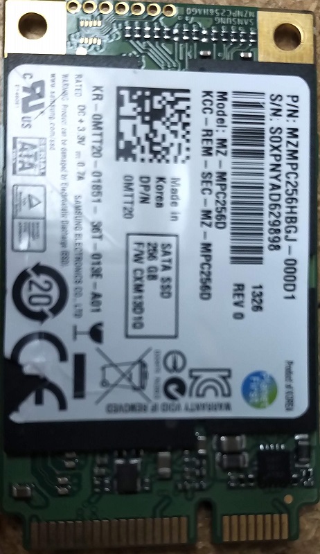

Model: Samsung 256GB 830 Series
Controller: S4LJ204X01-Y040
Solution: Short to kernel mode. Use virtual ldr and generate virtual translator. Reads with bad blocks (~ 1/2% of sectors are unreadable)

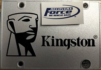

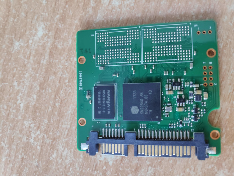

Model: 120GB Kingston SUV400S37/120G
Controller: 88SS1074
Symptoms: Client and technician couldn't access the drive
Solution: Failing NAND, able to clone with DDI with lots of bad blocks, but most are readable with multiple long timeout passes.
120GB Kingston SUV400S37.jpg (59.88 KiB) Viewed 246175 times
