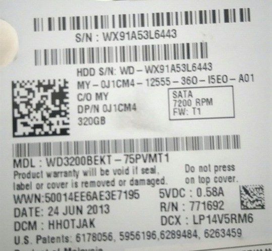

Extremely sorry ,You right,please find attached pic
Re: Need LDR for WD3200BKET-75VMT1
Ah, as I suspected. As I mentioned I have those other ones, but not the version you're looking for. You can probably use one of them along with the corresponding ROM code to at least read the tracks, then extract the proper module 11 from there. I've had to do that quite a number of times.
You can get any of them yourself on my firmware server: https://www.data-medics.com/forum/firmw ... s-t28.html
Sorry...I finally had a chance to check and we only have with firmware T0. Did you try contacting donor drives to see if they have it?
