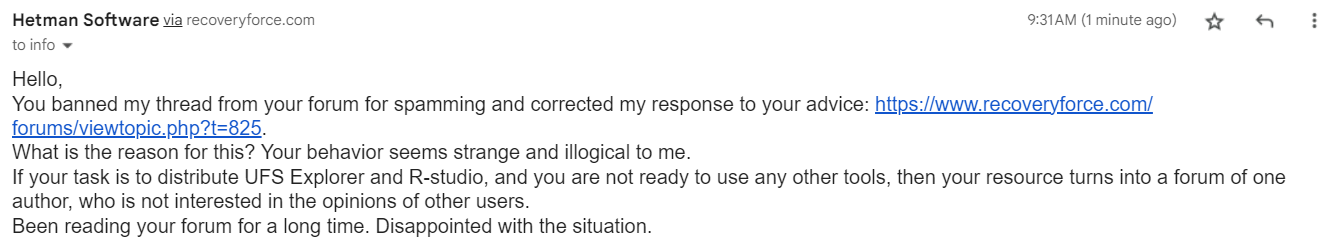

This is the email response I got for banning this author and a link to the thread that they posted under a different username on hddguru - https://forum.hddguru.com/viewtopic.php?f=7&t=43875
Re: How to recover data from Buffalo NAS LS-WXL236
So amazing he does not see that not telling the World about his software is not the issue, but pretending to be an end user is ..
