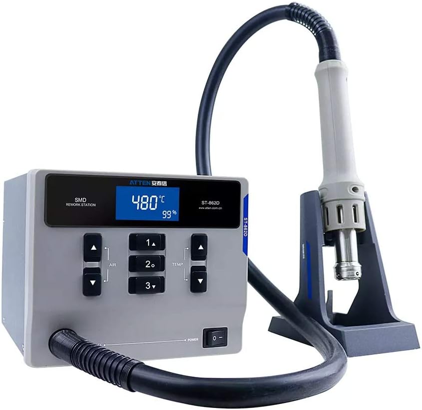

If I needed a hot air rework station for rom swap. I could get one of these, unless there is something cheaper?
Normally I like good tools that last a long time, have adjustable air flow, and won't blow other components off the PCB.
This is what Louis Rossman's repair company uses...
ATTEN Professional ST-862D Hot Air Station

I'm not suggesting that a chip swap is mandatory (I don't know). I'm just making the observation.

Just planning ahead. Not buying anything until I need it.
