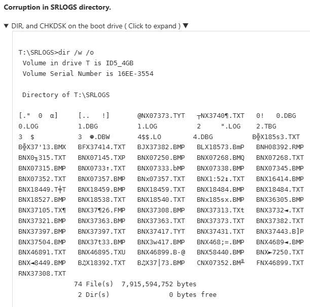

What did Mr Gish Gallop do that made this happen? Wonder if he used FORCEBIOS? :roll:
Looking at his bug report again, I think he forced use of USBCHK to access the full USB drive as SCSI.
But probably failed to to the proper hash checks and is seeing the 137GB BIOS USB Limit Bug.
That would explain the corruption.
Screenshot 2023-11-23 044755.png (59.23 KiB) Viewed 97399 times
CrazyTeeka wrote: Thu Nov 23, 2023 4:51 am What did Mr Gish Gallop do that made this happen? Wonder if he used FORCEBIOS? :roll:
File I/O is a DOS function and so this essentially a DOS issue. And a drive full issue. With testers like him it will be another few years until 6.1 hits the streets.
