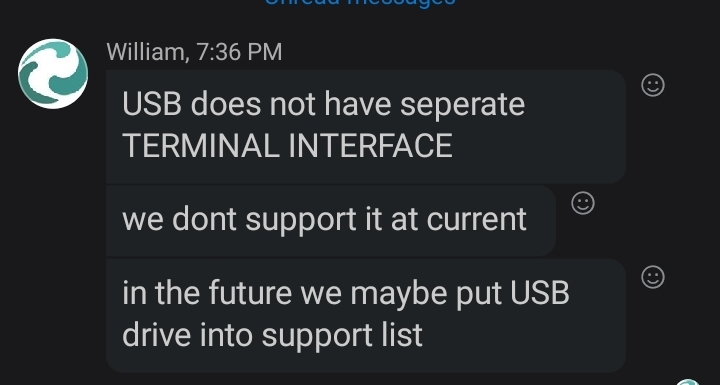

In watching the video, it looks like we should be able to read the ROM without removal with the DFL reader, use MRT to modify it and use DFL to write it back. But, the video examples only show SATA models being worked on, which makes me wonder how it will work with the USB variants.

This is disappointing.
