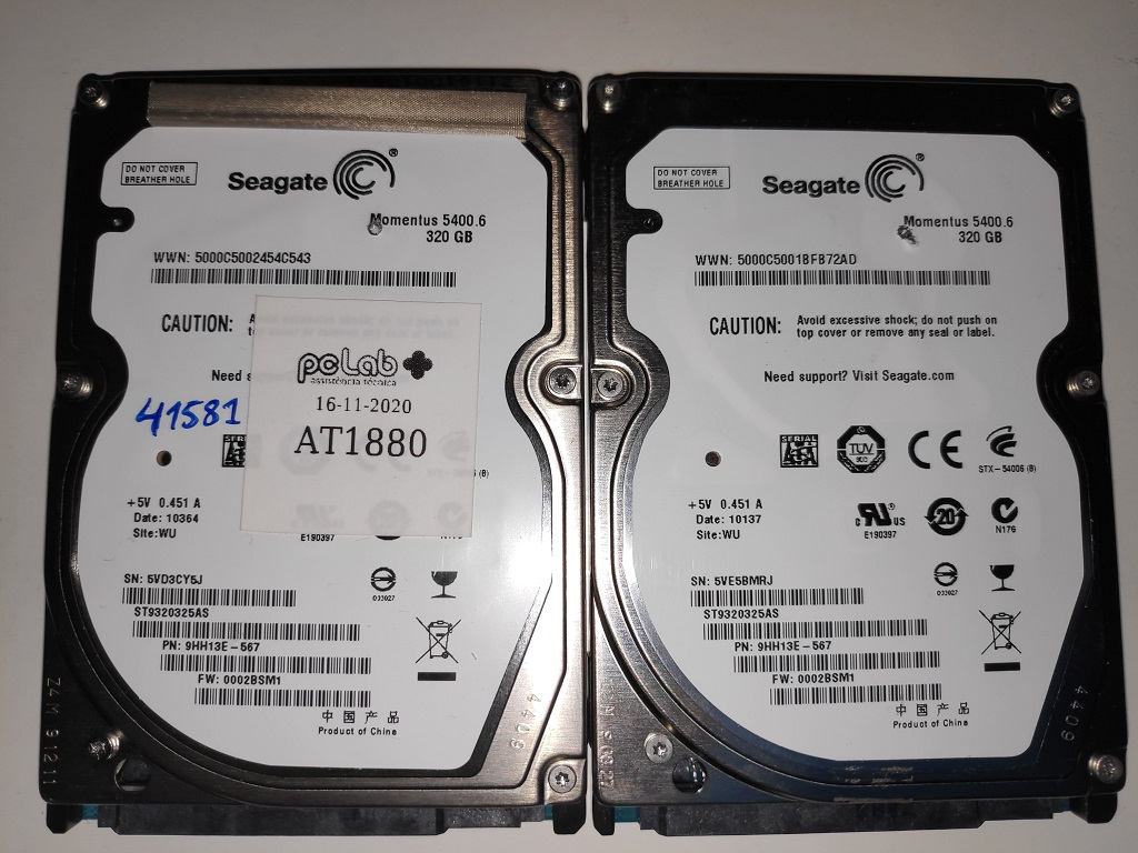

Patient have 3 heads and donor 4 heads
Head 2 of patient didn't read.
Swapped head's with a donor with different head map and head count and full recovery.

Awesome job! Thanks for sharing. Is this the case that required 6 head swaps to complete?
Re: ST9320325AS Recovery
It took 6 donors to find the right one. Matching the usual stuff didn't worked.
