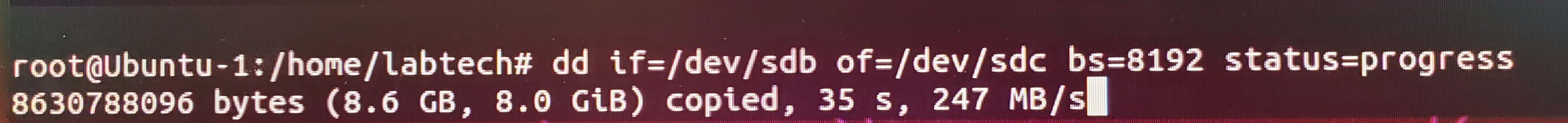

dd - 247MB/s

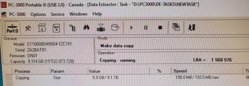

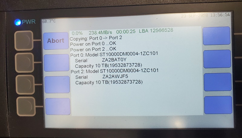

PC3K-Portable (direct) - 238MB/s

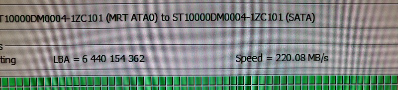

MRT - 220MB/s
PC3K-Portable (USB) - 190MB/s

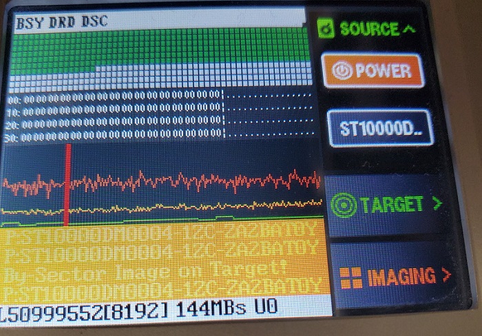

RapidSpar - 144MB/s

* Assuming that PC3K-Portable uses a default of 4096 in the read block size, the top 4 faster systems were reading the larger size, while the others are using 512 (an aassumption for RapidSpar)
** I missed getting DeepSpar Disk Imager added, but I think it is safe to say that it would likely be the slowest of the systems, when dealing with healthy drives.
