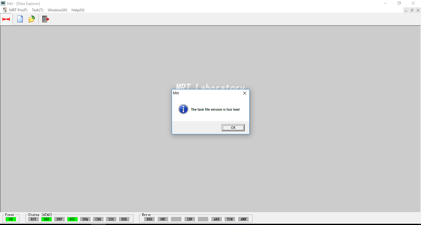

First issue discovered already. It won't open previous version DE tasks. Now we wait another 6 months for them to fix it and charge another $120 for it?
Re: MRT software version 2.1.2.3 update log
Here is a blog on how to migrate an old DE task to the new version.
https://www.recoveryforce.com/how-to-mi ... sion-2123/
