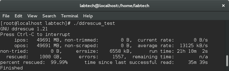

ddrescue finished the first default pass yesterday.
Now I've set it to clean up with a -r 3 (3 retries) setting. Currently it has been running for 1d 41m, is on Retry 2 and has dropped the errorsize to 6449 kB and errors to 1468.
On the surface, it is looking like ddrescue might be getting a better result than the original run of DDI4. But, when we ran DDI4, our main focus was recovering a client's data, not getting the best clone possible for the entire drive. So, we would have focused our bad sector cleanup strictly to the targeted file structure. But, this is why I will be redoing the DDI4 clone for this test.
Re: How do they stack up?
Posted: Thu Feb 16, 2017 1:29 pm
by lcoughey
ddrescue finished the 3 retry cleanup after almost 38 hours.
So, with a combined total of 59 hours of imaging, ddrescue was able read all but 6434 kiB (12,868 sectors) . I've attached the ddrescue log file to this post.
Now, let's see how hddsuperclone will do, in comparison.
