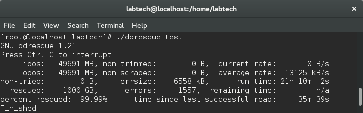

ddrescue finished the first default pass yesterday.
Now I've set it to clean up with a -r 3 (3 retries) setting. Currently it has been running for 1d 41m, is on Retry 2 and has dropped the errorsize to 6449 kB and errors to 1468.

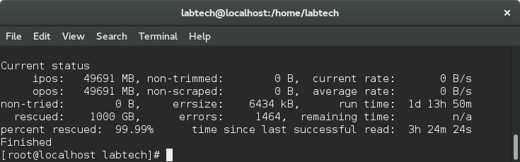

ddrescue finished the 3 retry cleanup after almost 38 hours.
So, with a combined total of 59 hours of imaging, ddrescue was able read all but 6434 kiB (12,868 sectors) . I've attached the ddrescue log file to this post.

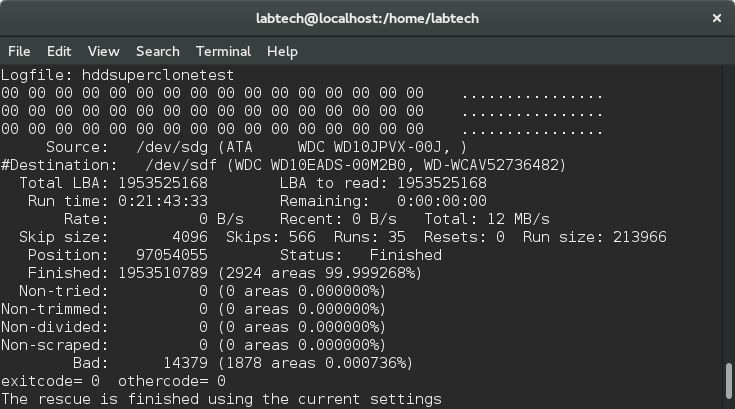

After a full run of hddsuperclone with default settings:
As I did with ddrescue, now running with a 3 retry setting to see if it can cut into some of those unread sectors.
Re: How do they stack up?
Here is the final result of HDDSuperClone after about 62 hours for running.

According to the log, ddrescue actually recovered all but 12568. But the estimated first run of ddrescue without retries would have been about 13166, would would be real close to the 13128 from DDI4.
HDDSuperClone recovered many less sectors (14360 total), and did not gain much at all during the retries. So my question is, is the drive degrading? Or is it repeatable that ddrescue can recover that many more sectors than hddsuperclone on this drive?
