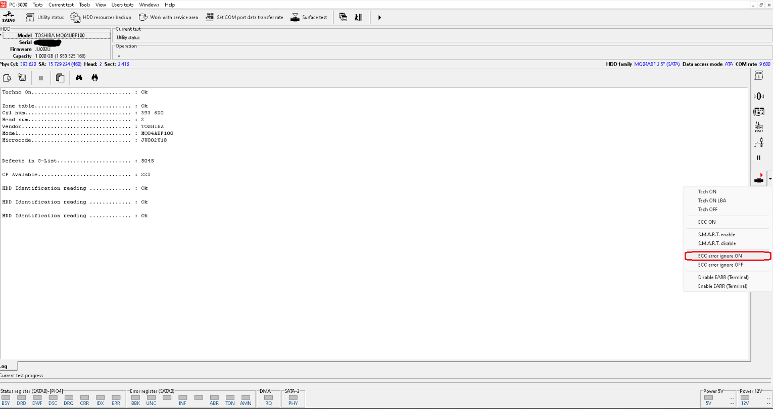

Hi!
I have 2 doubt and 2 problem at the same time.
Selected family:MQ04ABF100
Model:TOSHIBA MQ04UBF100
Load Zones : .........................:OK
Cyl Num : ............................:393620
Head Num : ...........................:2
Vendor : .............................:TOSHIBA
Model : ..............................:MQ04ABF100
Microcode : ..........................:JU002U18
I made usb to sata, it was perfect but...
I cloned 80% of the HD with the function:
"ECC ERROR IGNORE ON" Enabled...
Could this cause sectors to be read the wrong way? Corrupted?
Thank you for the opportunity to post on this forum.

1. Does the drive not read without ignoring ECC?
2. Can you see a file tree and open files in DE?

Whit fuction EARR disable, support is more stable, but I have noticed that these MQ04 units have serious compatibility problems when you mount new heads, in fact it happened to me already two or three times, that with new heads, from identical donors, where only the construction period changes the sectors are not read, or they are read but they seem to have some type of encryption.
