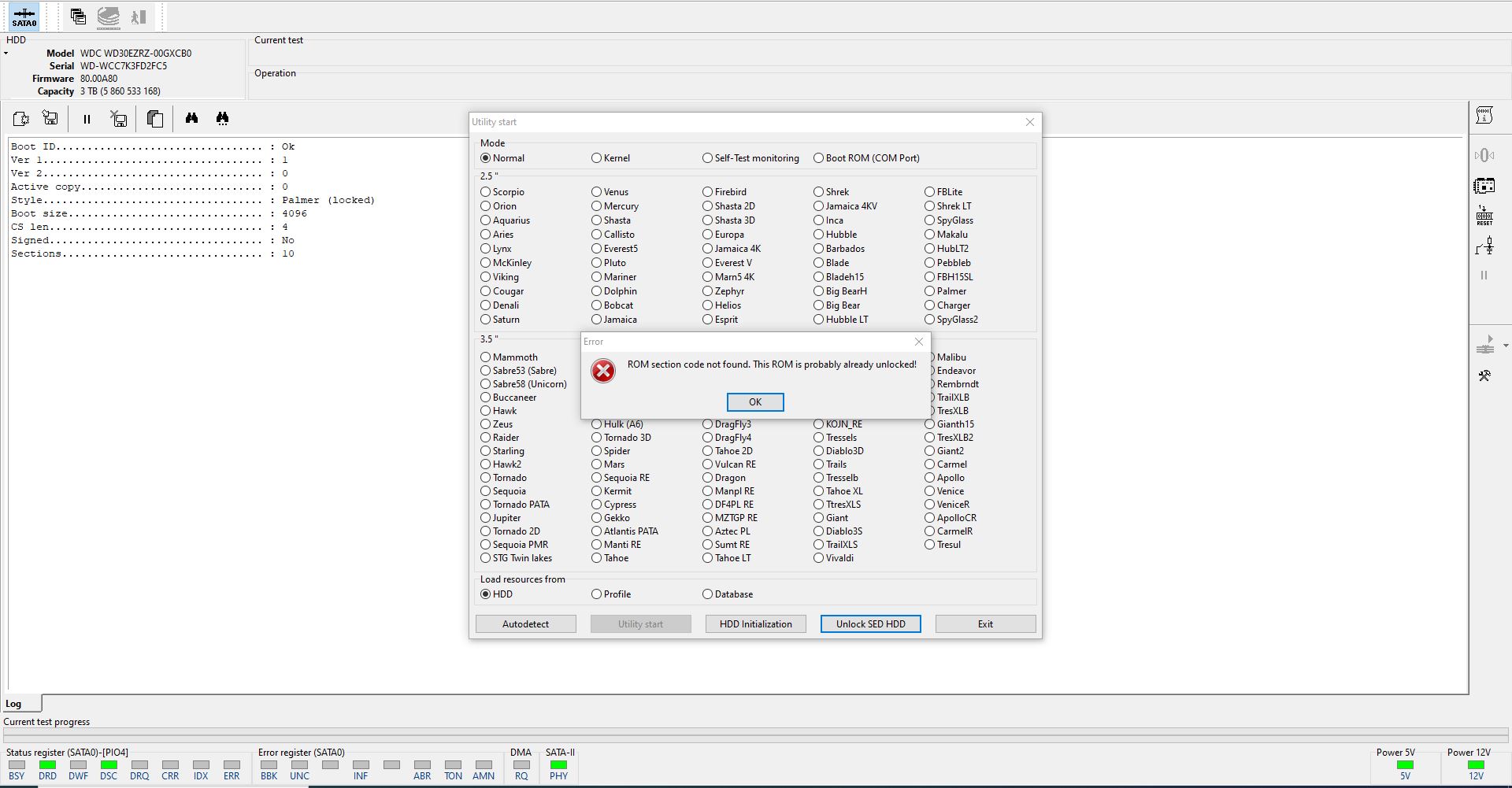

I am handling this drive (WD30EZRZ-00GXCB0) PCB: 800055, and when I apply the patch I get the message that the ROM is already unlocked.
The drive get DRD DSC and full ID.
See screenshot attached.
I have PC3K version 7.1.6. Maybe it is not supported?
Thanks for any hint
Error-Apply-Unlock SED HDD.JPG (207.09 KiB) Viewed 36348 times

What are you clicking on in that screen?

lcoughey wrote: Thu Nov 10, 2022 2:15 am What are you clicking on in that screen?
Unlock SED HDD
The problem was SED (firmware) and not ROM locked.
I already solved it by blocking access to SA and then loading the loader.
By the log it looked like the locked ROM of the new SMR drives.

Okay...wasn't clear on exactly what you were doing.
