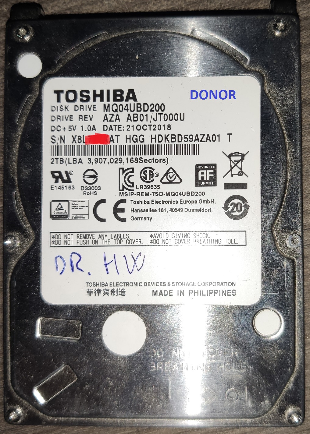

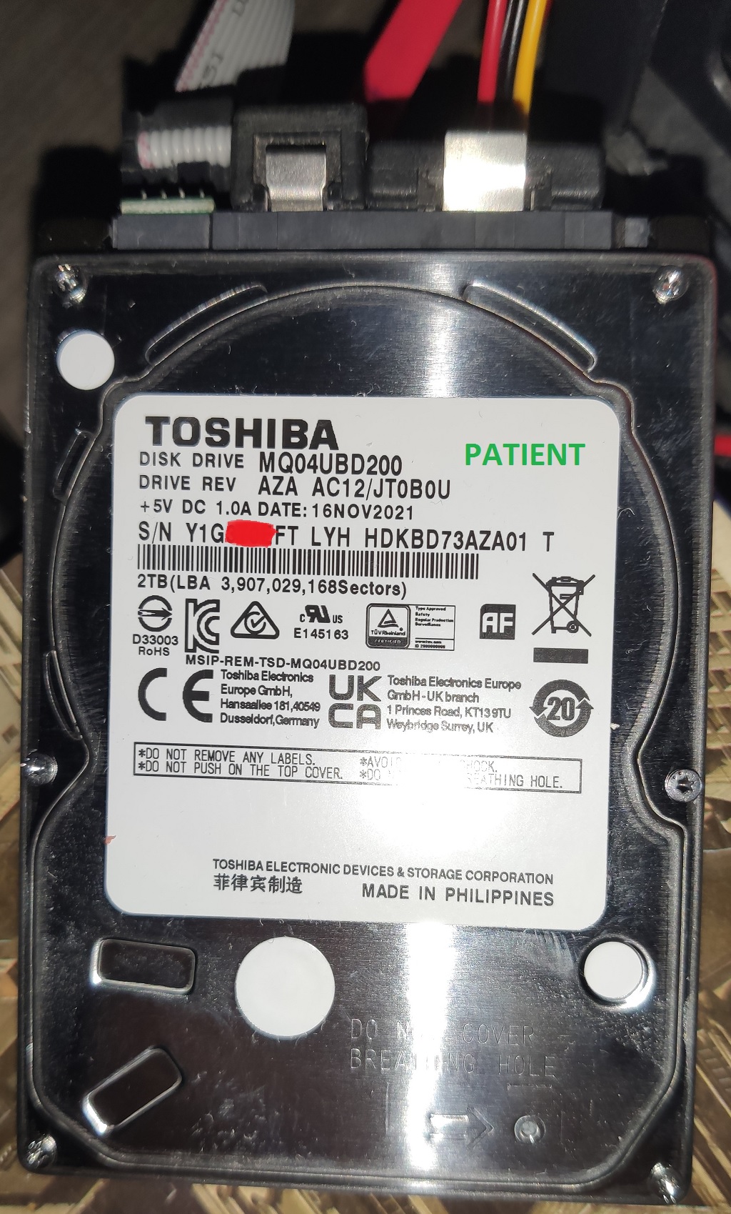

i need to swap heads on a MQ04UBD200 patient drive.
I've a MQ04UBD200 donor drive, i need to know if in your opinion heads are compatible with the patient.
Donor drive is 37 months older than patient.
Donor Cyl num: 361612
Donor SPT: 3632
Patient Cyl num: 355807
Patient SPT: 3840
Toshiba MQ04UBD200 compatible Heads compare

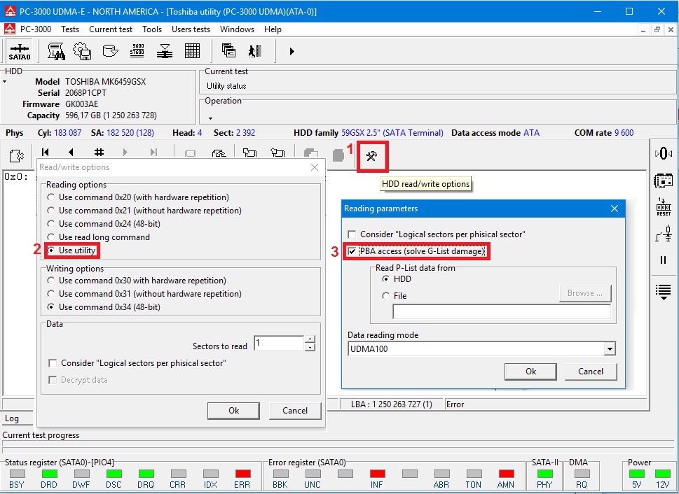

I turned off ARRE via terminal with SP command and i used option "read from active utility" enabled in DE. I was able to clone about 250.000.000 LBAs by ticking only the second option (which is PBA access, solve G-list damage), as is shown on Acelab blog.
I didn't tick the 1st option which is "CONSIDER LOGICAL SECTORS PER PHISICAL SECTOR"... should i tick also this one?
Now the drive is reading worse, also with this option enabled it stops reading after 1 second and gets very busy, but he can continue very slowly in PIO mode (of course only through utility).
