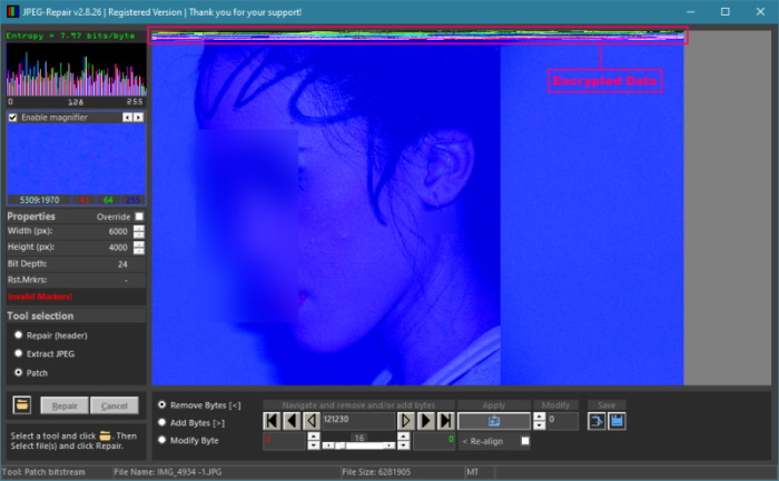

So, in cases where decryption fails JPEG-Repair can be used to repair individual JPEG and RAW photos with some degradation to quality. In case JPEGs embed restart markers, original color can be fully restored too. JPEG-Repair can not batch this, each file requires manual intervention.
In this example JPEG-Repair glued a header on top of a corrupt JPEG. Part of it's standard routine is stripping from byte sequences that are invalid JPEG markers and as a result the data can now be decoded. You can clearly see the corrupt/encrypted portion of the file at the top of the image. Now you can cut corrupt bytes from the file and re-align the image using stuff bytes as shown in this video: https://youtu.be/aiLofQEPoEs.
