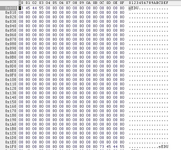

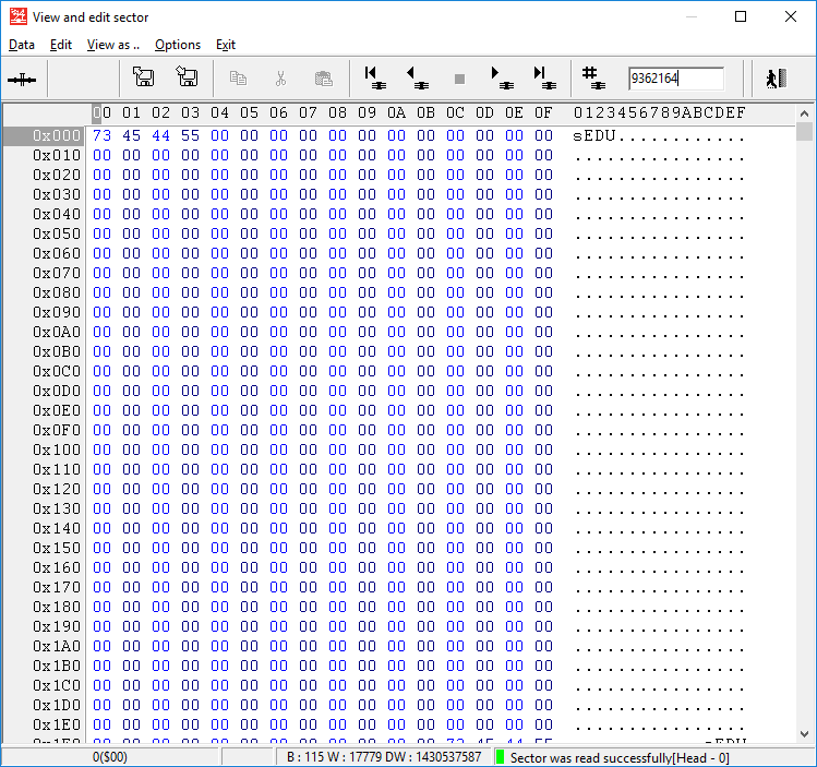

I have another drive with similar issues. This time with "sEDU"
Patient Drive - ST2000LM007, 1R8174-568, WDZ..., SBK2, 4 heads
Perhaps it is only with this model that this issue occasionally happens. Not enough cases to make that call.
Update: changed the heads and the garbage sectors are slowly reading good data now. But, as before, still getting random sectors read with the corrupt pattern

I have a completely different model with similar symptoms. This is with donor heads and the garbage isn't in every sector read with the one head, head 0, in this case. But, what is interesting is that every case I see this happening in, the one thing that has been consistent is that it always seems to land in the MFT or HFS+ catalog.
