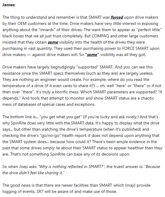

What if SMART just doesn't feel like sharing much on this drive?
Maybe the answer is to stop trusting SMART.

CrazyTeeka wrote: Wed Nov 15, 2023 4:13 pm What if SMART just doesn't feel like sharing much on this drive?
Yes, that's a typical answer from Steve G, half way between I don't know and a conspiracy theory. It's bullshit, and in my experience pending and reallocated are usually accurate regardless the drive brand.
He also contradicts himself, when SR6 was introduced he sort of promised SR would make SMART data useful (also mixed with some vague claims of drives hiding important stuff), reality is that he gets half of the SMART stats wrong. For example, SR hasn't got a clue about SMART stats as reported by Seagate drives.
When I pushed him for an answer how het arrived at this theory: ..

Joep wrote:For example, SR hasn't got a clue about SMART stats as reported by Seagate drives.
Steve distrusts SMART because he doesn't understand it. As you say, the one time that he tried to make use of SMART, he made a complete mess of things. His mistake was to apply intuitive logic to a counterintuitive case, specifically a Seagate drive. Essentially, SpinRite took a perfectly healthy drive and just kept spewing out thousands of bogus errors.
