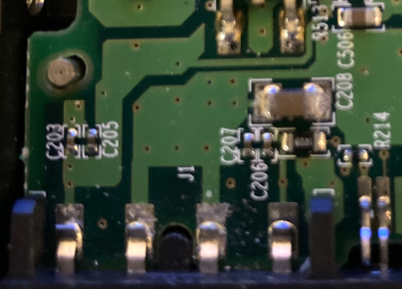

I would test the preamp by measuring the resistances between Ground and each of +5V and -5V supplies at the HDA connector (pins 4,5,6).
https://www.hddoracle.com/viewtopic.php?p=138#p138

Re: Maxtor DiamondMax Plus 9 120GB PCB Issue No Power
I think you mean these pins, so using 4 as ground I get no readings off 5 and 6 at all.
I'm not sure whether the pinout is the same, or maybe there's an error in my HDD Oracle article.

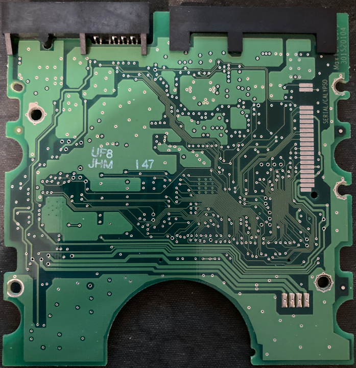

Can you show us a photo of the underside of the PCB?
So a working PCB would probably be the easy way to get this drive working again?
Or I could just mail it to Recovery Force for spare parts?
The pinout looks similar, so your preamp would appear to be OK. At least it's not shorted.
