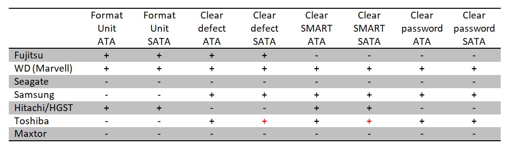

No, but I can always grab more drives off eBay.
I was going to try to find some Fujitsu/WD (Marvell)/Samsung/Toshiba drives with bad sectors, so I can clear the G-List myself. But the tool has no support for Seagate drives and newer WD drives which appear to have changed the vendor specific commands...
