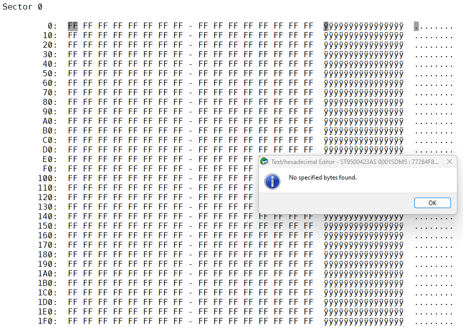

All caught up on what happened over the weekend.
Going to use hash values to compare some files before and after a level 5 scan.
Going to use a fill pattern of "FF" to check if that firmware bug occurs when reading good sectors.
R-Studio can search whole drive for bytes that are not "FF".
UK based lab agreed to clear g-list for me which should bring those 81 bad sectors back.
I really hope that Steve has listened to all the feedback, and changes to safer practices over historical practices.

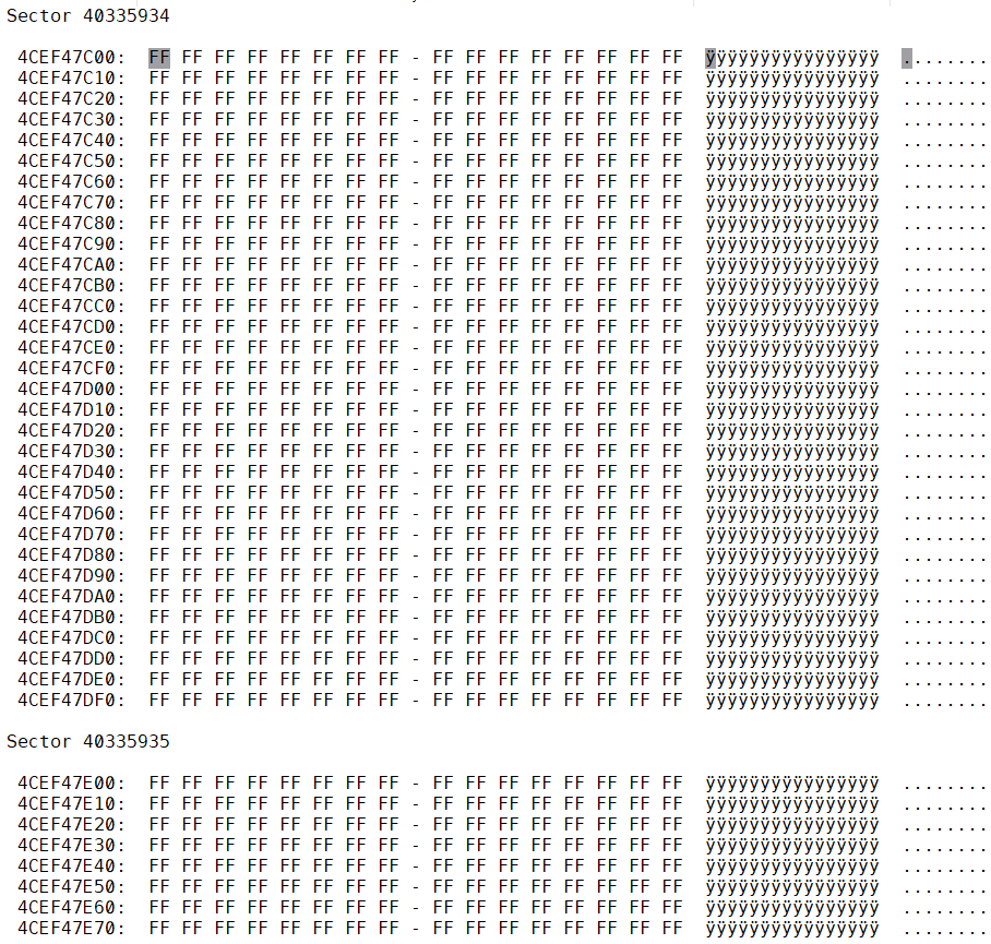

Drive seems to read fine once good spares have been swapped in. I guess that means firmware issue only manifests with bad sectors?
Searched whole drive for hex values that are not "FF": Checking that 2 specific sectors read back the same data that was last written to them:
