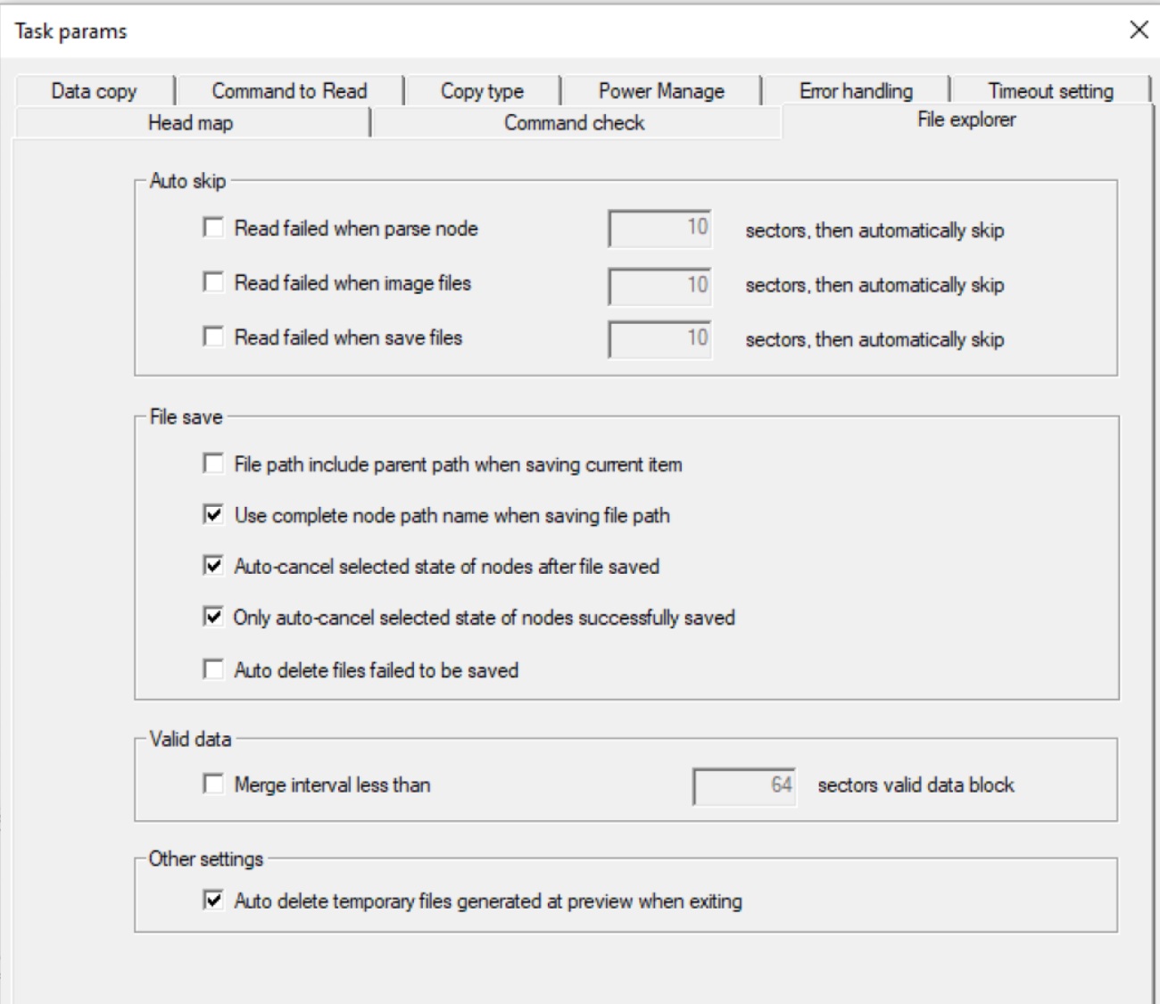

After years of complaing to MRT about their insisting on added a bunch of uncessary details to the file path when saving client's data out to the destination drive, it still doesn't work. When you select various files and folders within the file tree to save out, you want the same file and folder paths to used for the saved data.

Option 1 - select "File path include parent path when saving current item"
When you choose this, it adds folders to describing the drive partitioning and the partition from which the data is being saved to the file path for the data being saved.

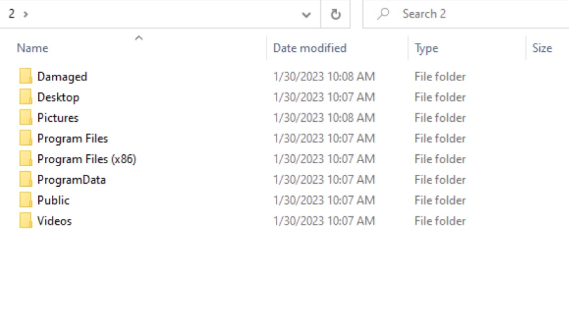

When it causes files in sub folders to exceed the file path limits, a new folder in the root of the save path is created and the files are dumped there, without folder paths and causing serious issues when there are file duplicates and no way of knowing where those files are supposed to have been saved. Basically, it is absolutely idiotic, to say the least.
Option 2 - unselect "File path include parent path when saving current item"
When this is unelected, it doesn't keep the folder paths, rather it just saves the selected folders in the same spot, loosing their folder paths.

Option 3 - unselect "File path include parent path when saving current item" and only select folders in from root
As a work around, I can't select specific files and folders within the Users folder, rather I have to select the entire Users folder, temp files, cookies and all. This is a nuissance because we may not have bother imaging the temp files and cookies and it can add a lot of time and space to save out the extra data that our client doesn't need or want.
